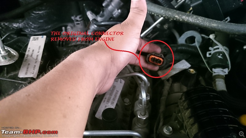

Mahindra TUV300 : Official Review-original-socket.jpg
This is the original connector from the stock ECU. This orange colored piece is connected to the inlet socket of the RD box as shown in the below picture

The orange colored connector shown in the previous photo is connected to the socket of the RD Box, in the top circle.
