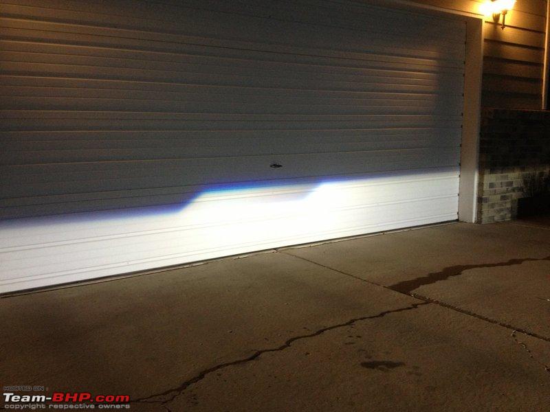

An interesting observation. My crysta zx Low beam LED lamps show a glow of blue + yellow around the edges of illumination . I feel that the Light coming out from the LED dome, hits the headlight glass and causes some prismatic effect.
Does your observation look anything like this?
If not, it’d be great if you could post a picture of the same.

Attached photos sorry I could not get a really dark parking to get the view, but even with a lit parking area the "yellow/Blue" tinge looks very evident.

I'd suggest creating a racket closer to expiry of warranty. To me seems pretty ok, maybe just a tiny bit of movement in the LED bulb that is showing the cut off in a different manner.

This is completely normal, as the cutoff shield is prominently dispersing light into several colours.
I won’t be able to give you the technical terms behind it, but I can assure you that nothing is wrong with the headlights of your car.
Here are some pictures from the low beam of our 2.4 ZX.

It is not the cutoff shield but the actual projector lens assembly which causes the light to disperse into different colors. The headlight cutoff itself is provided by the aforementioned shield. Unless I am mistake, the Crysta like most other cars uses fresnel lenses as the projector which usually cause a yellowish tinge to appear. My E90 BMW as well as Hyundai Santa Fe both exhibit the same effect albeit with xenon lights.
If you'd rather have just the blue "flicker", you can swap out the lens with completely clear lenses such as those used by Infiniti (luxury division of Nissan here in North America). It will more than likely void the warranty on headlights however the upgraded lenses provide a much sharper cutoff and significantly improved light output.

I actually intended to write projector lens instead of cutoff shield, but made the mistake as I was in a hurry.
Yes, you’re right about fresnel & clear lenses.
The latter even lets the projector perform to its fullest, whereas the former detunes the same.
