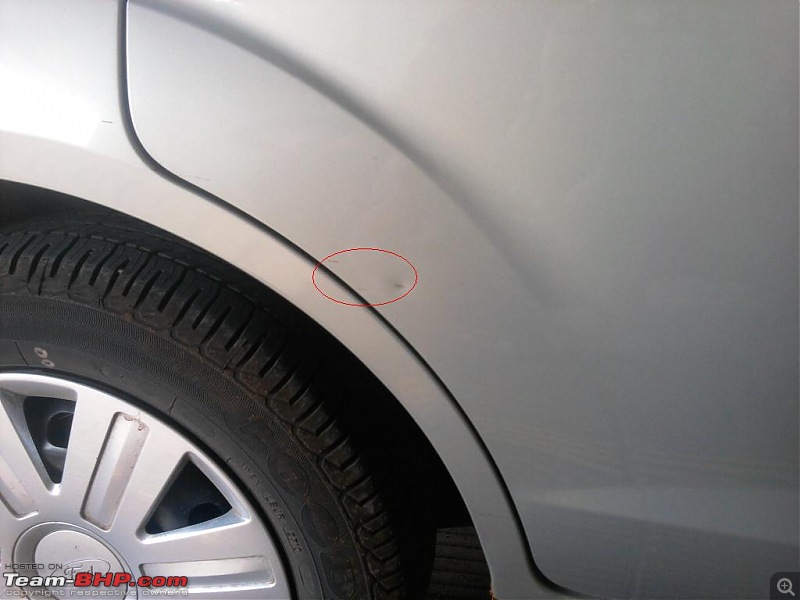

Not sure if this is the right thread. But i got a dent on my new Figo (not sure how) and was wondering whether i should do anything to prevent any further damage to color.
I have attached the pic

Sorry for the dent!
If the scratch however catches your fingernail, then its just too deep to remove.
Other scuffs seem pretty superficial
The deeper one can be touched up with a superfine brush or a needle!
For paint protection, you might wanna consider getting a PP film - Welcome to LLumar website
