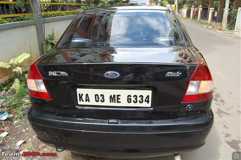

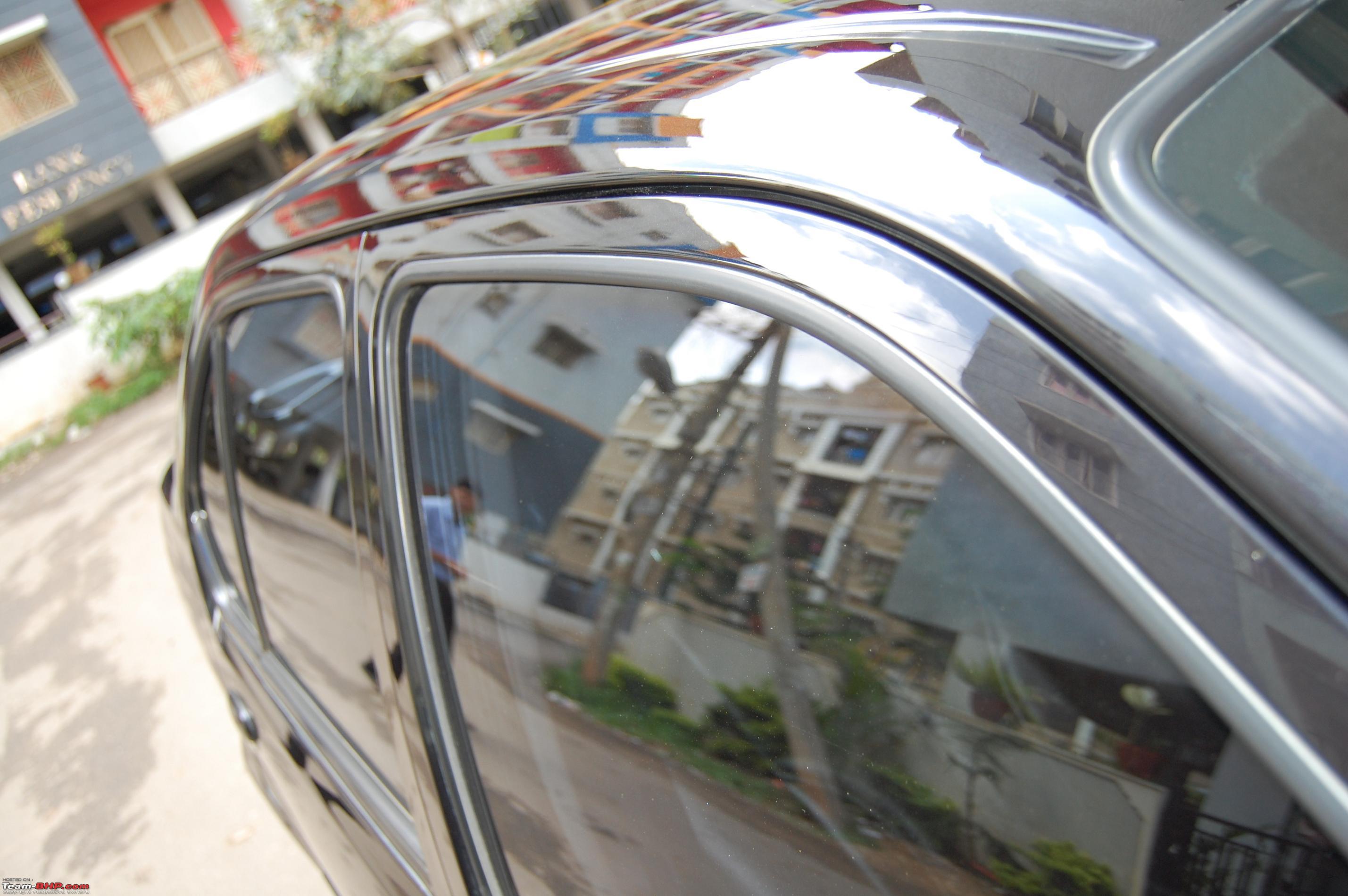

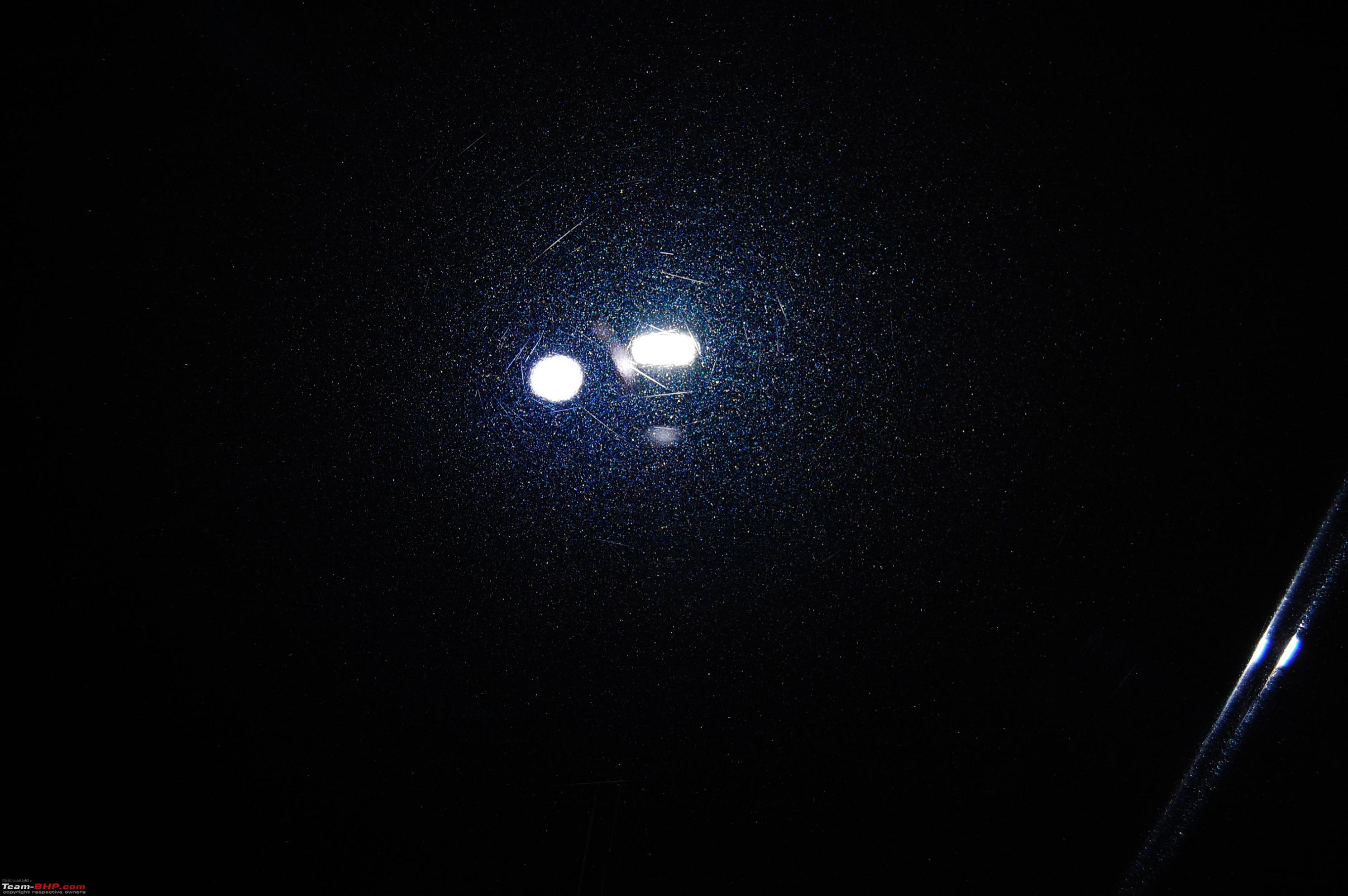

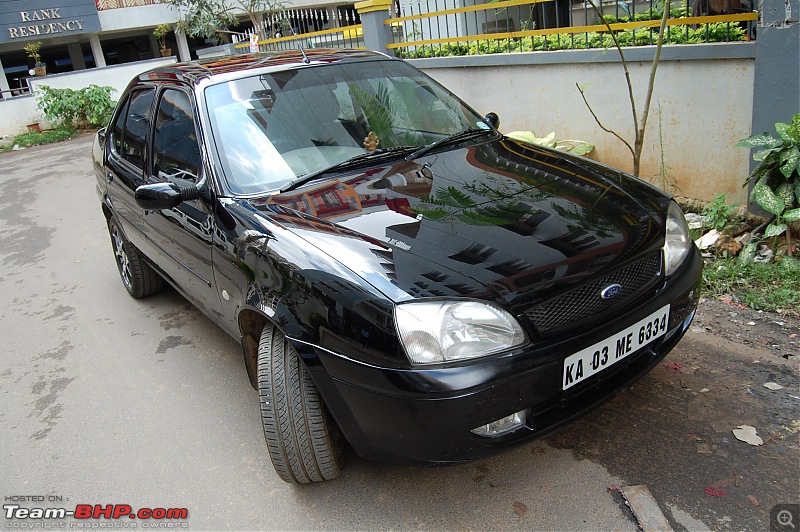

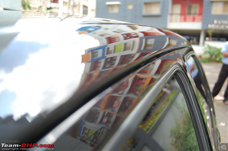

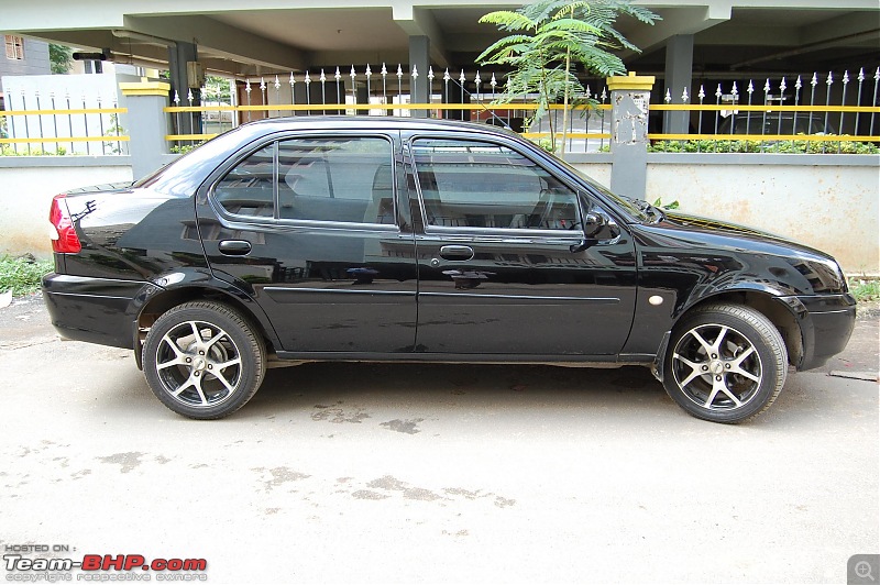

Job "Whale done!!!"
Hi All,
Its been quite sometime that i started looking for car detailing work for my ikon. It was aging by the exterior paint worn outs but the heart(engine) was still young. I possessed this machine way back in 2005 as my dream car. The skin had become too dull and swirl marks on it made me to lookout for sale. But when enquired with ***, heard the paint was in good condition and required mere car detailing work on it.
Had recently bought my second car Figo, got 3M polish as free service but wasn't quite satisfied with quality. So did not want to go for it for my 5+ yr old ikon, which had deep swirl marks on it almost everywhere.
Tried the demo at Sai colorium, quoted 2000 for it but the results were not satisfactory. Was looking for some option of car detailing, where i can learn the process by myself and get the detailing done to my satisfaction for a reasonable cost. Thanks to T-bhp, i found a car enthusiast- "mkh" who owns ANHC and results on it were awesome coz of their passion towards it. I went and saw the car in person and immediately asked him to do my car over with his products. He was doing it so patiently that I could feel that genuinity towards his work. For much lesser cost than a 3M treatment, i got a much better work done and that too from car care lovers, who have a passion for this. Now i know how to maintain the finish now, will go for another round after 6-8 months now.
I did learn the entire process of car detailing, used Megauire products. I must say "WHALE DONE"
Let the pics do the rest of the talk.
Posting few pics here of Before and After.
