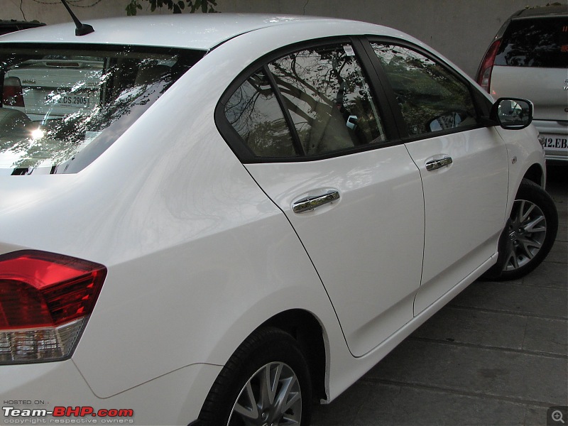

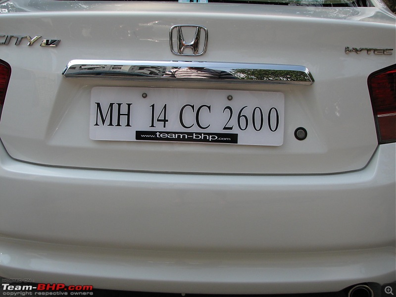

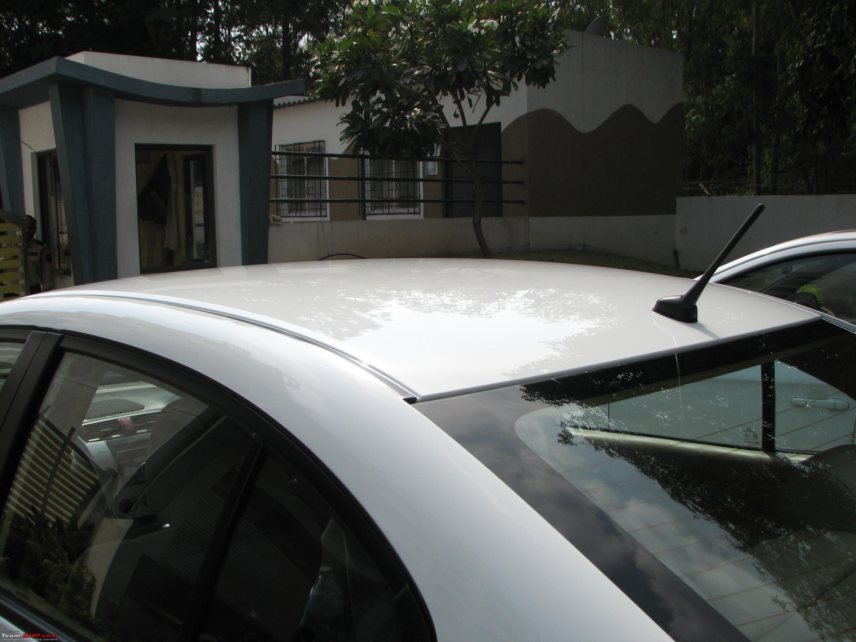

Just finished with detailing of my taffeta white ANHC.
Guru's let me know your feedback
Process followed (All by hand):
0) Plain water wash.
1) Trutle Wax Platinum Series Performance Car wash.
2) Claying (meguiars clay kit).
3) Paint Sealent - Meguiars NXT TechWax2.0 (2 coats - in between curing time of 12 hours).
4) Insulator Wax - Collinite (2 coats - in between curing time of 12 hours).
Worked on each panel-by-panel and all this took me over one week.
Before continuing with between steps the was cleaned with plain water wash or sometimes just California duster.
Question to Guru's: Should I top this up with UQD ?? or it won't make any difference over insulator wax ??

Steele,
Great job. The car is stunning. Very nice.
Am i right, if i say that you have left out the tail lamps and the headlamps.
Have you worked on the alloys too ? How new is your car ?
By the way, does it take a week to do be done with the detailing?

Just one word SUPERB! Whenever i visit the thread i get complex seeing all the gleaming beauties. I for one has not even waxed the car for the last 6 months! Bad bad me!

nandans2005, Jaggu, thank you.
BTW Please note all these detailing was done by hand & muscle. I don't have Polishers or DA's to work on fast.
Why do you say so?? Please point me to the deficiencies you noted if any.
Well for headlamps and tail lamps they were thoroughly cleaned during different wash as noted earlier. Then during Collinite-845 session I apply some to get rid of residual Collinite from the applicator sponge. The advantage is nothing sticks to your headlamps, it works good I experienced this during monsoon.
Yes, I got a pressure wash done before i started with detailing. Then during (Trutle Wax Platinum Series Performance) Car wash step they were thoroughly brush cleaned inside out. This step left a thin protective layer of wax. Then applied 2 layers Colloinite after curing. Now the alloys are spick and span as nothing stiks to them. They can be easly cleaned now even with splashing water or mere California duster is enough.
My ANHC VMT is exactly 6 months old & clocked 10.7K kms.
Well, I worked on this like 1 or 2 hours a day, wasn't possible to work everyday, compensated by some extra time on Sundays. The steps that were performed and in between curing time involved resulted in a one weeks period.
My observations from White: Its very difficult to obtain & catch the same gloss on whites vs. on dark colours. You can notice the gloss on grille in 2nd pic vs. the white.
The second problem is catching the result in camera. The autofocus go berserk while focusing on white, I had to shoot with manual focus. Its very difficult to catch the reflections on white, still managed to some extent.
The pics in my opinion only expresses 75-80% of impact than what I see with eyes. In physical the car gloss-shine is much better than waht it appears in pics.
Lastly, Question to Guru's(Nirmal, MKH, Sohail, others if I missed someone): Should I top this up with UQD ?? or it won't make any difference over insulator wax ??
