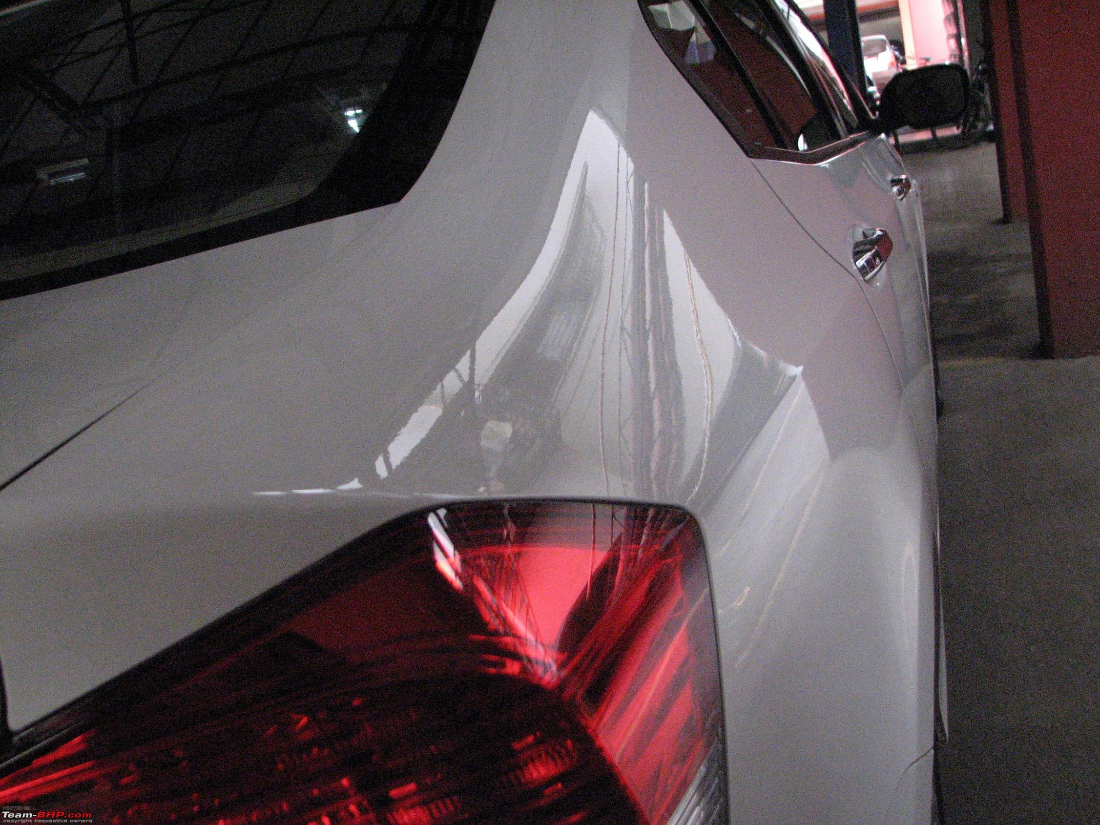

Thanks rk_sans.
I was thinking if Black UQD containing Hydrophobic polymer will add to protection and gloss if applied over Collinite-845. (as it is post Collinite the finish is super smooth and super glossy with depth).
Here attached are some more pics clicked in my parking.
Checkout the Alloy finish.

@ STEELE,
yes, the tail lamps does look very nice and shinning like new ones.
The alloys are done really great.
These pictures angle are better.
Great work. I think you can do wonders with DA !

Thank you nandans2005.
How I wish, I could afford/justify getting a DA, may be some day I will overcome that feeling.
