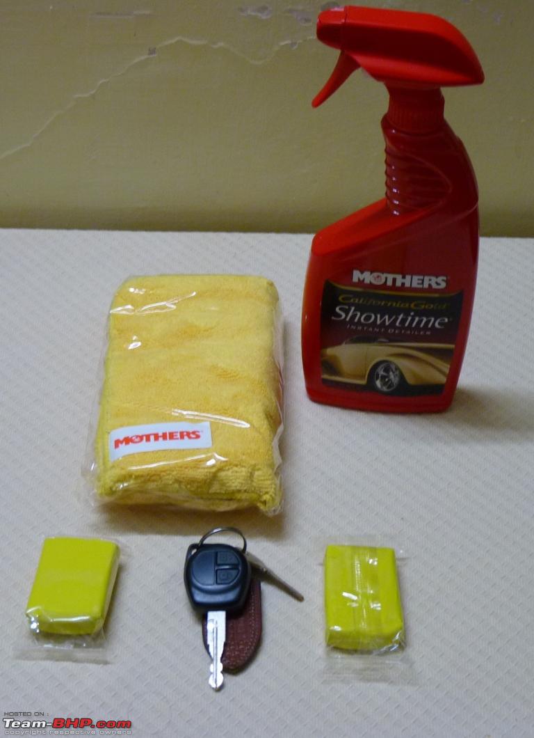

A closer look at the Clay package and its contents

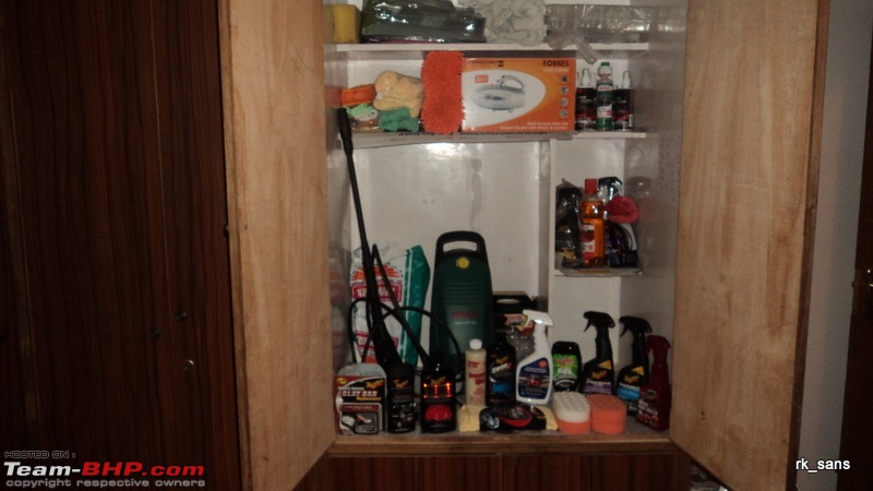

Guys,
Finally my detailing kit is updated once again except the major component DA polisher. I am missing that very badly.
