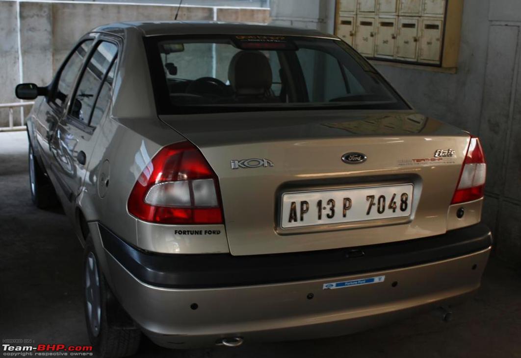

This weekend, my days were spent washing, claying and then waxing my Car and bike. I was pleased with my effort. I used Mother's California claying kit and Formula 1 car wax.
Here is the result.
I know there's scope for lots of improvement. Next time I'll also polish after claying. But have to say that the surface feels very soft now after claying.

^^ nice results and you got same bike as I have Also ordered jopasu duster from ebay, lets see how long it takes here to arrive.
