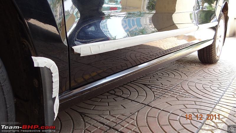

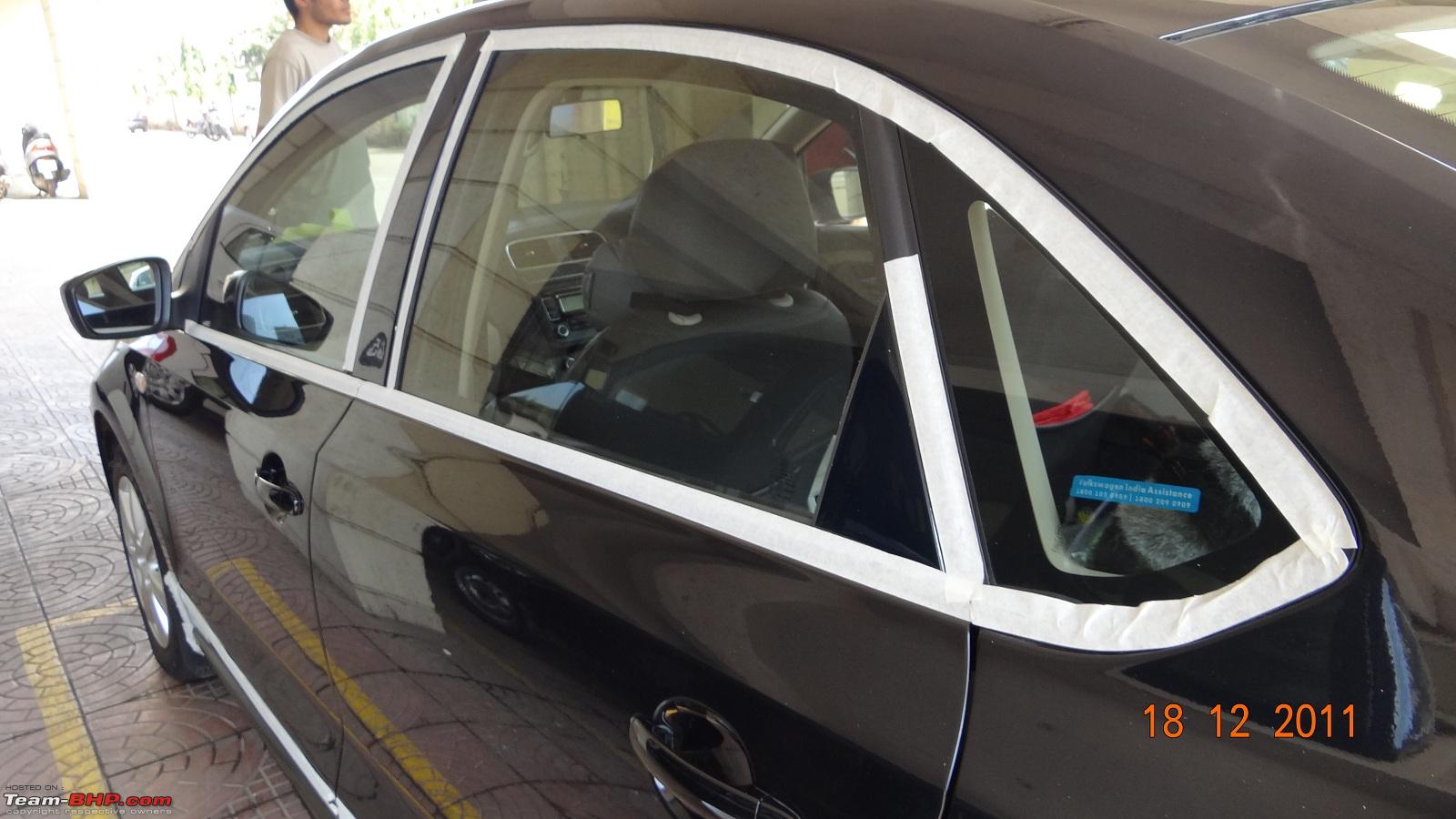

Next Step:Masking.
Did the masking of the plastic parts outline, door protector and window sill. Used ABRO masking tape for the purpose, costed Rs. 30 for 1" by 30 mtr.
A superb Car cleaning, polishing & detailing guide-masking-side-protector-mud-flaps.jpg

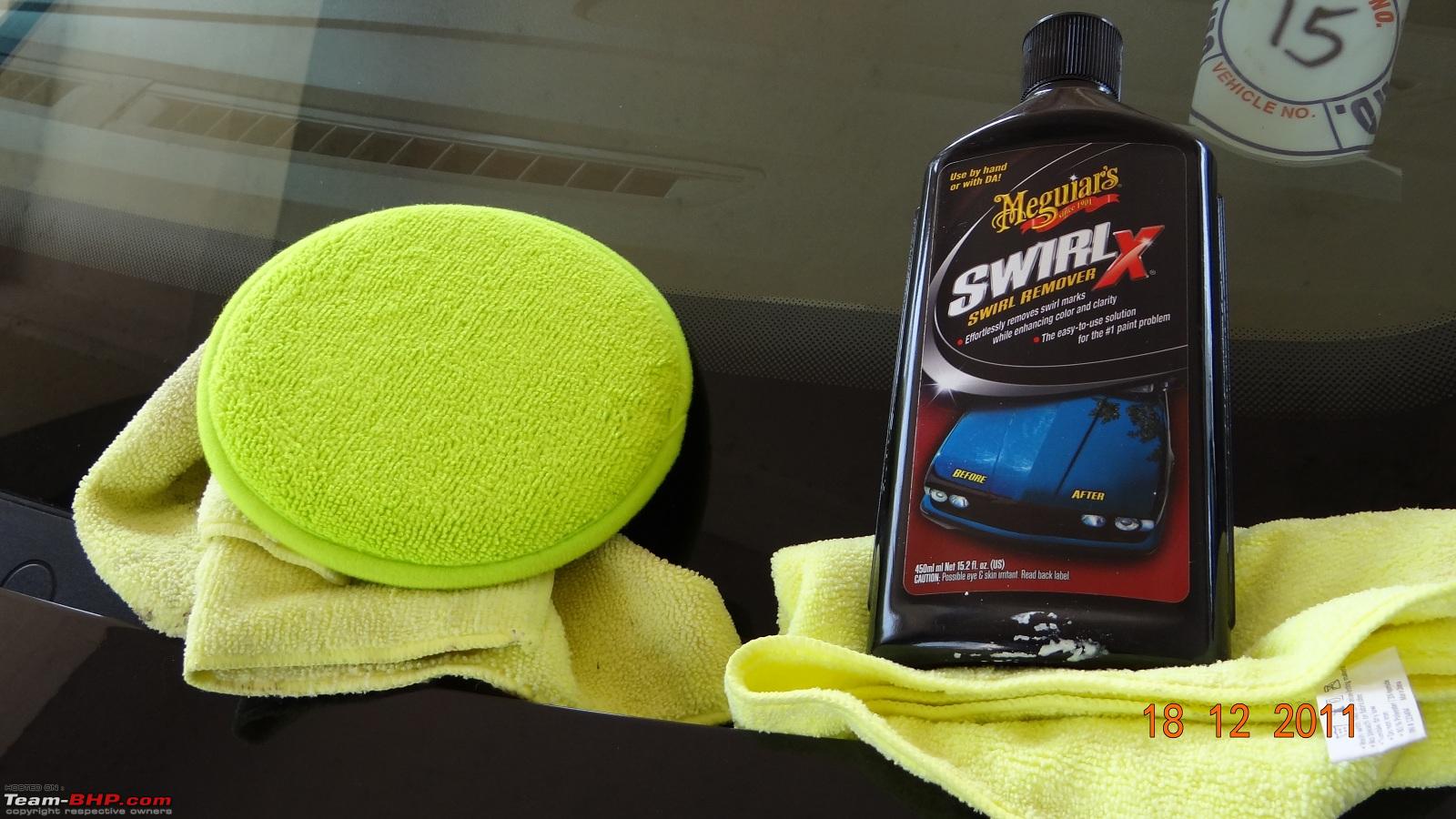

Next step: Swirls & scratch removal.
Used Meguiars SwirlsX swirl remover to get rid of the swirls. SwirlsX is quite a potent liquid, as it even got rid of scratches which previously couldn't be removed by Formula1 Scratch Out.
I can't imagine what the Meguiars Ultimate Compound would be like. SwirlX removed 90% of swirls and car looked like new after it was done.
SwirlsX is very tedious to work with. Used Viking applicator pad for applying it. Did a good work. After applying SwirlsX in circular motions let it haze. After it has hazed just use a MF to clean the surface.
A superb Car cleaning, polishing & detailing guide-meguiars-swirlsx-viking-applicator-pad.jpg

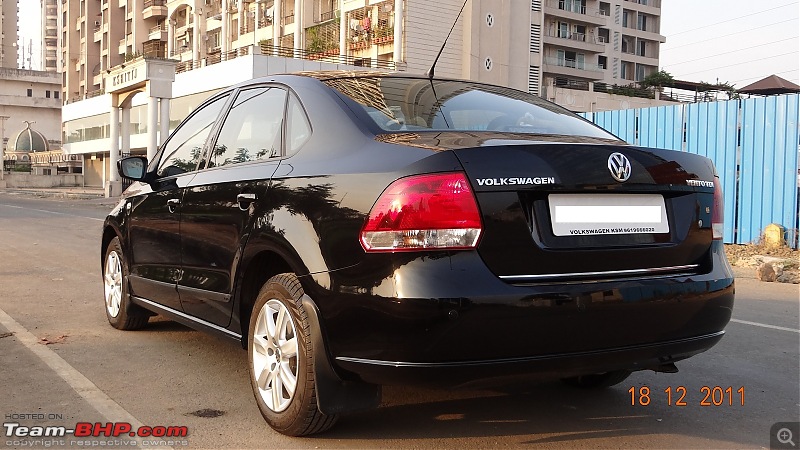

Final result & a small photo shoot.
