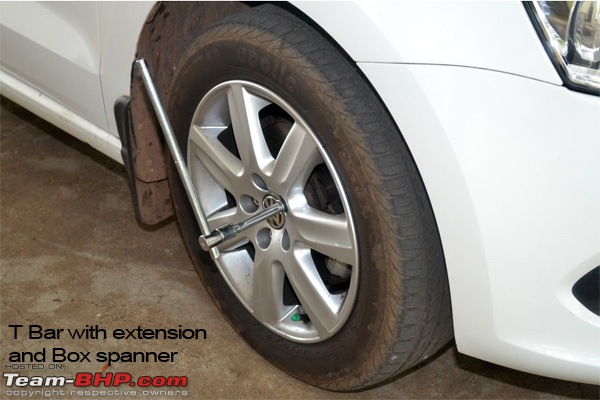

The wheel spanner comes next. The car should have one. Just make sure that you upgrade it if you choose to change your wheels to alloys. The advantage of using T Bars and lock on box spanners is that you can get extension pieces which effectively makes sure that the bar does not damage the alloy wheels.
Too often, the wheel nuts are over-tight and jammed. The easiest way out is a long pipe to increase the leverage slowly and gently till the nut is released. Once free, use WD40 or equivalent to keep it free. NEVER, Never use the pipe to icrease leverage to tighten the wheel nut.
You do not wanna do that. wheel fasteners shouldn't be too lubricated. I'm sure you know why.
Plus, basky, Its not too clear from the pics, but have you jacked the car up on its anti roll bar with the jackstands??

Our road conditions here are quite different and threads fill up with very adherent muck including brake dust. Spray WD40 on it and blast off everything with the pressure washer. Only a clean surface remains. No trace of the solvent remains.
Ans:No

Originally Posted by basky View Post
Wheels & Arches
Getting the Wheels and arches clean is a painful process but if you have the tools, it becomes easier. The overall effect of a good cleaning is simply dramatic.
Well you just made my day. Even I have a Vento TDi Highline pearl black. I'm also planning to clean the wheel and arches like you have done on all 4, coming Sunday.
The thing is I would be doing one at a time using the jack provided by VW to lift the tyre, remove it and clean the wheel well and put the tyre back again.
Did you get it done from some car washing shop or have you done it yourself?
Did you even wash the engine bay? Did you even remove the under hood cover which is provided in TDi?
What are your suggestion as I would be doing it all by myself? Any special agent used for agitating the brake dust to clean the alloys?
