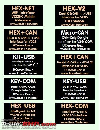

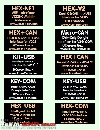

Hi guys, can anyone please tell me which is the latest software of Rosstech available on Aliexpress with vcds cable? I have 2007 Skoda Laura L&K DSG AT and also let me know which software is to be downloaded? There are multiple options like the attached file
VCDS (Vag-Com Diagnostic System) for VW & Skoda - Discussion Thread-vcds.jpg
