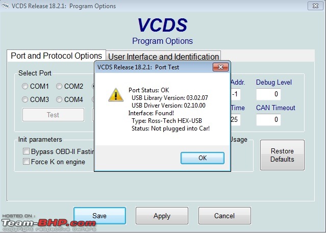

Dear Epic,
Thanks following your lead I received my VCDS from EOBDTOOLS.
I installed the VCDS Loader on my Laptop.
The installation asks that VCDS be connected to hardware before it can be registered. Does it mean the Cable has to be plugged in to the car at one end and Laptop at the other end before the registration can happen OR I just connect the cable to PC at one end( I know it doesn't make sense), but I am afraid of the car systems going haywire if I keep it connected while I register the device.
Could you kindly guide me on this.
Thanks
MADMAX111 is offline
Old 26th September 2018, 13:34   #645
Epic's Avatar
Join Date: Jan 2007
Posts: 1,572
Thanked: 1,015 Times
Re: VCDS (Vag-Com Diagnostic System) for VW & Skoda - Discussion Thread
Originally Posted by MADMAX111 View Post
Dear Epic,
Thanks
Hey!!
The hardware (cable) needs to be connected to the laptop (not the car) so that it can be registered.
Once the cable is registered you should get a message like this:
VCDS (Vag-Com Diagnostic System) for VW & Skoda - Discussion Thread-vcds-status.jpg
This means that the USB port and VCDS has detected your cable and it is working fine. You can now go ahead and plug it in your car and it should work as it should.
You may also get a message saying 'Interface: Not Found'. In this case you will need to contact the team at OBDTool. You can WhatsApp them on 008613728823411 and they reply almost immediately. In my case they even went to the extent of solving my issue through Team Viewer. So in terms of support they are fantastic!!
