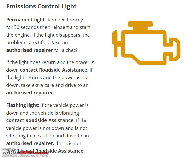

I got a strange problem on my Yeti 2012. Got these two errors.
This (Engine Management Warning Light) is flashing.
Name:  Engine Management Warning light.png
This (Emissions Control Light) comes later and stay on.
Name:  Emissions Control Light.png
The car sounds very different (like a 3 cylinder engine) and power is down on throttle input.
Did a VCDS scan and found the following fault:
Address 01: Engine (J623-CLCB) Labels: 03L-906-018-CFF.clb
Part No SW: 03L 906 018 EK HW: 03L 906 018 BR
Component: R4 2.0l TDI H23 9977
Revision: 42H23--- Serial number:
Coding: 00190012040700080000
Shop #: WSC 20177 663 00000
ASAM Dataset: EV_ECM20TDI01103L906018EK 003010
ROD: EV_ECM20TDI01103L906018EK.rod
VCID: 77FD0D57CE389FA6A59-8022
1 Fault Found:
5085 - Injector: Cylinder 3 (N32)
P0203 00 [167] - Circuit Malfunction
MIL ON - Not Confirmed - Tested Since Memory Clear
Freeze Frame:
Fault Status: 00000001
Fault Priority: 2
Fault Frequency: 1
Mileage: 67516 km
Date: 2079.14.03
Time: 10:41:02
Readiness: 0 0 0 0 1
As my search on google, found the following, the most common causes for this code include:
  • Defective cylinder 3 fuel injector
  • Plugged or dirt in fuel injector
  • Corroded fuel injector, connections or wiring
  • Poor or broken electrical connections in the connector or harness
  • Open or short wiring harness for the cylinder 2 injector circuit
  • Defective fuel injector power circuits
Any idea how to narrow down the source of the problem?
If it helps, I had a stage 1 remap done from Petes 1.5 years back.
