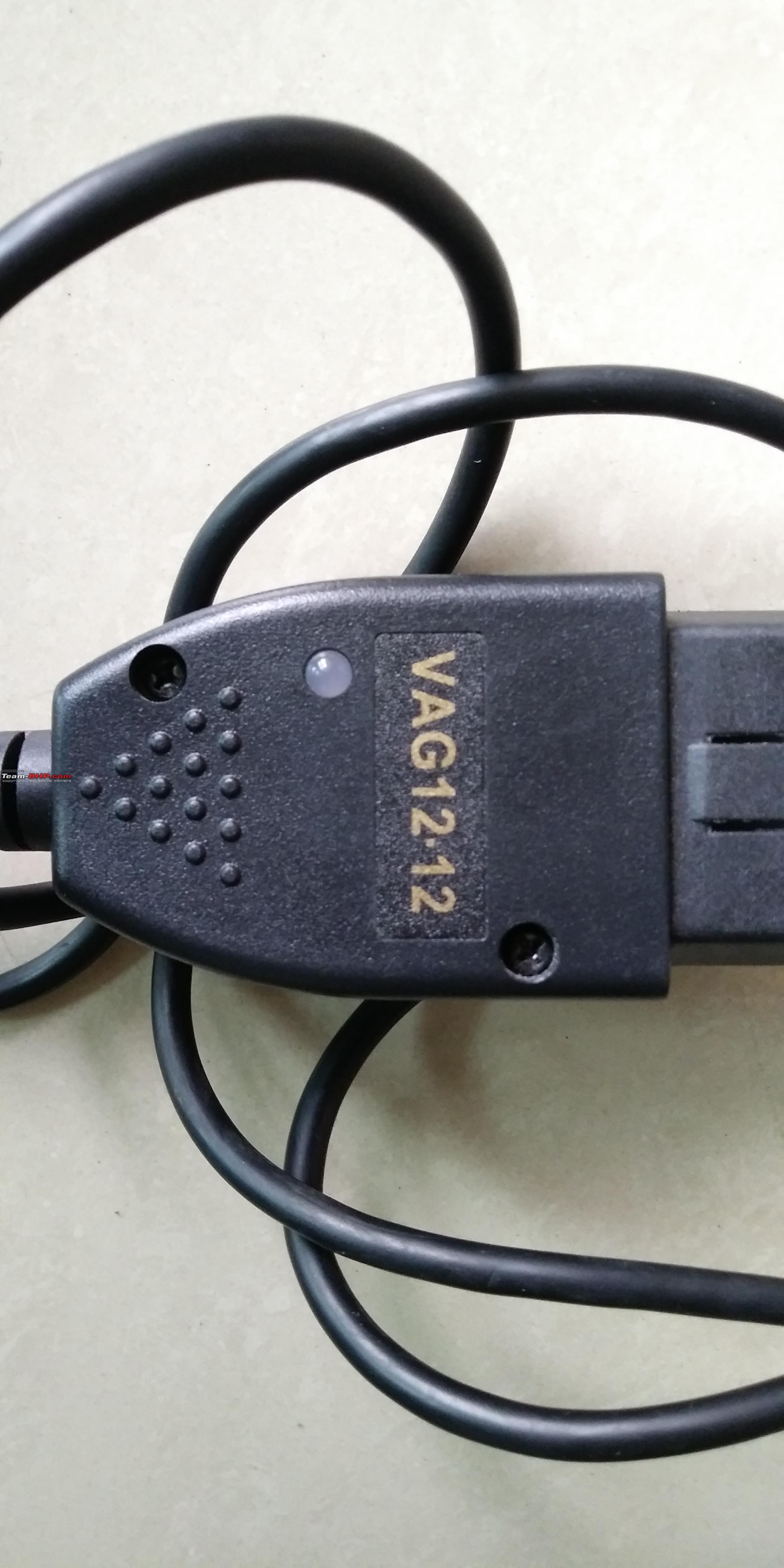

Hey Epic
Can you check if their is a version written on your cable. I had the same problem when I tried to use version 18.12 on the cable I bought couple of years back and was working on 12.12.
I uninstalled the latest version and installed version 12.12 and it worked well.

Originally Posted by jazzyrajat View Post
Hey Epic
Hi. There is no version written on my cable. I bought my cable and software through AliExpress.com so it is not original but a copy. The version is 17.8.1 which is not upgradable.
I have now bought another cable with the 18.2 version. Awaiting delivery of the same. Let's hope this one works.
What about yours? Where did you get your cable from?
I also bought it from Aliexpress and it worked without issues. I had downloaded the software from ross-tech website everytime I needed.
Wish your other cable works fine!
