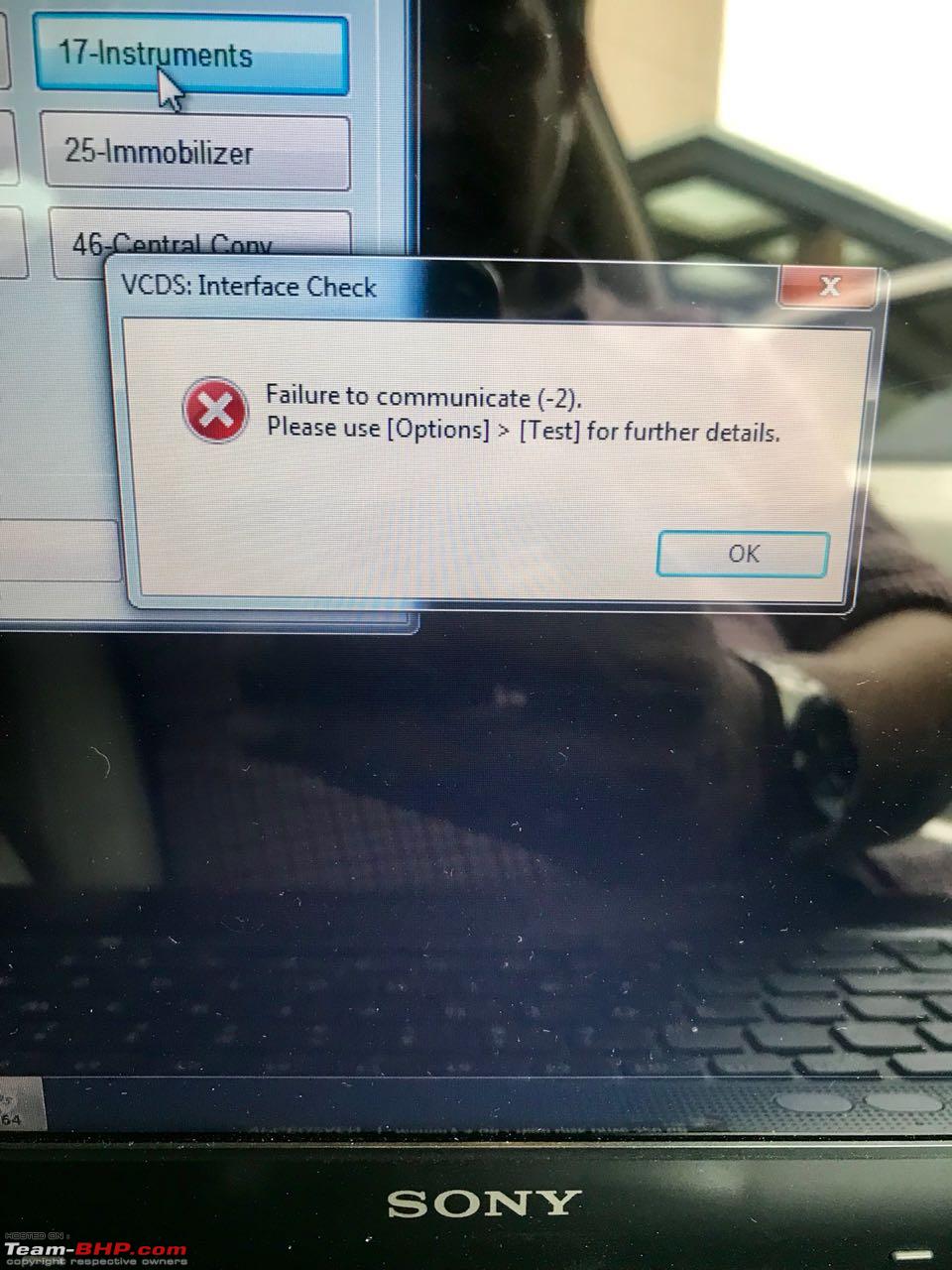

Reviving this really old thread as I am having an issue setting up my VagCom
Bought a VagCom cable and software through AliExpress.com and tried it out today for the first time hoping to activate the 'Needle Sweep' function on my 2015 Jetta DSG.
So I am aware that the initial set up needs you to successfully connect and save a port (which is the USB of a laptop) post which one can access the functions. I am however unable to get this done through any of the USB slots on my laptop. If I plug in the USB the LED indicator is 'orange'. Once the cable is attached to the car's port, the LED indicator shows 'green' but I get this error.
VCDS (Vag-Com Diagnostic System) for VW & Skoda - Discussion Thread-vagcom-port-error.jpg
Now I am able to access the menus like 'Control Module', etc. So..
Select Control Module -> Instruments and then I get this error
VCDS (Vag-Com Diagnostic System) for VW & Skoda - Discussion Thread-vagcom-comm-error.jpg
I am unable to figure out the problem. Can anyone help?
Epic is offline

Hi Epic,
I have not used this new version however you can try following if not done earlier
1. Confirm presence of this cable in Device Manager of your laptop/.
2. Try connecting to USB 2.0 port if you were trying in USB3.0 (blue) port earlier.
3. If possible try to install software and test on another laptop.
I hope you are using the same version of software that came with this cable.
Regards.
I saw something to the effect that some cables aren't genuine. You may want to check this aliexpress link
swissknife is offline
I guess this confirms presence of the cable
VCDS (Vag-Com Diagnostic System) for VW & Skoda - Discussion Thread-device-manager.png

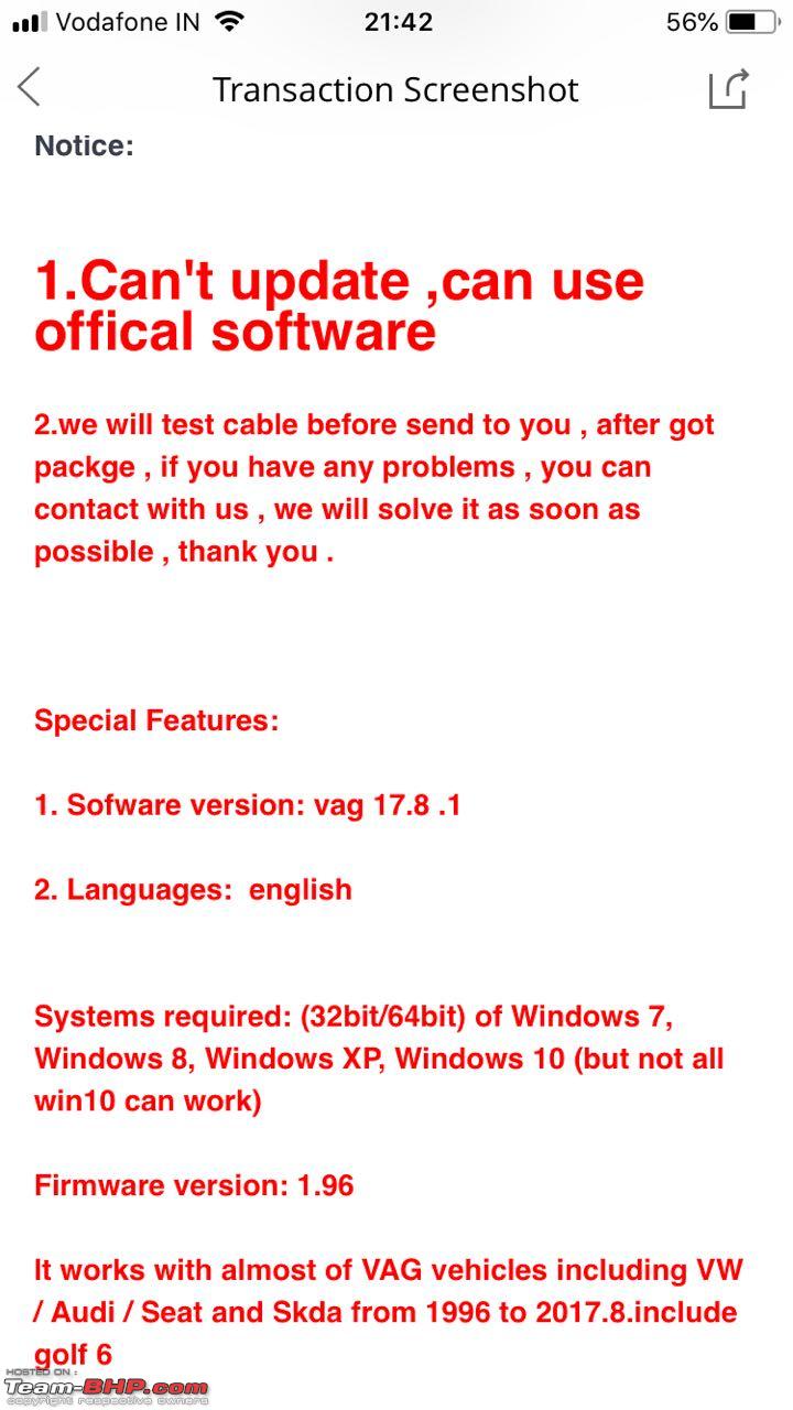

This is what I think could be the problem. The software that came to me is the 17.8.1 version. When I installed it on my laptop and launched it, there was a pop-up of an update of the newer version which is 18.2.1 and which I updated. Last night I messaged the seller and on checking the description of the item, I found a note saying that the software should not be updated.
VCDS (Vag-Com Diagnostic System) for VW & Skoda - Discussion Thread-aliexpress.jpg
I have now uninstalled all software and re-installed the 17.2.1 version again and will now try it out on the car. I however hope this solves my problem.
This could also be a possibility but will know once I try out the 17.8.1 version of the software again without updating it to 18.2.1
Epic is offline
Yes. That is the problem. These AliExpress cables come with a patched software and will work with only that particular version of the software. In fact, the vendors also give instructions to turn off internet while using the cable to disable the updates.
Mostly it should work if you uninstall the updated version and install the version that came with the cable. But if the updated OE software set some registry entries that the cable is bad, even after re-installing the vendor provided software, it may not work.
Hope the uninstall and re-install works.
