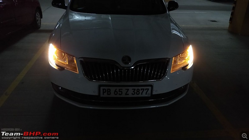

2. US Position Lamps : basically this setting enables the turn signals in a lower brightness levels in compliment to the DRLs. simulating the US lights which uses the Amber lights as marker lights
VCDS (Vag-Com Diagnostic System) for VW & Skoda - Discussion Thread-whatsapp-image-20171108-17.39.31.jpeg
VCDS (Vag-Com Diagnostic System) for VW & Skoda - Discussion Thread-whatsapp-image-20171108-17.39.54.jpeg

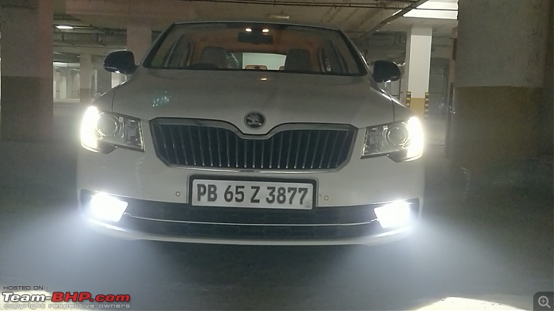

3. Changing Coming Home/Leaving Home Lights: by Default my low beam (Xenon) would have been activated for CL/CH functions, this i had already changed to my LED Fogs to save Battery loads and Xenons. To take this further, i tried complementing the fogs with Either the front LED DRLs or Front LED DRLs.
a. Front Fogs + Front turn signals as Coming home/Leaving home lights (Note: the front turn signals dont blink in CL/CH mode. they are static Amber)
VCDS (Vag-Com Diagnostic System) for VW & Skoda - Discussion Thread-whatsapp-image-20171108-23.07.12.jpeg
VCDS (Vag-Com Diagnostic System) for VW & Skoda - Discussion Thread-whatsapp-image-20171108-23.07.12-2.jpeg
b. Front Fogs + Front white LED DRLs ad CL/CH

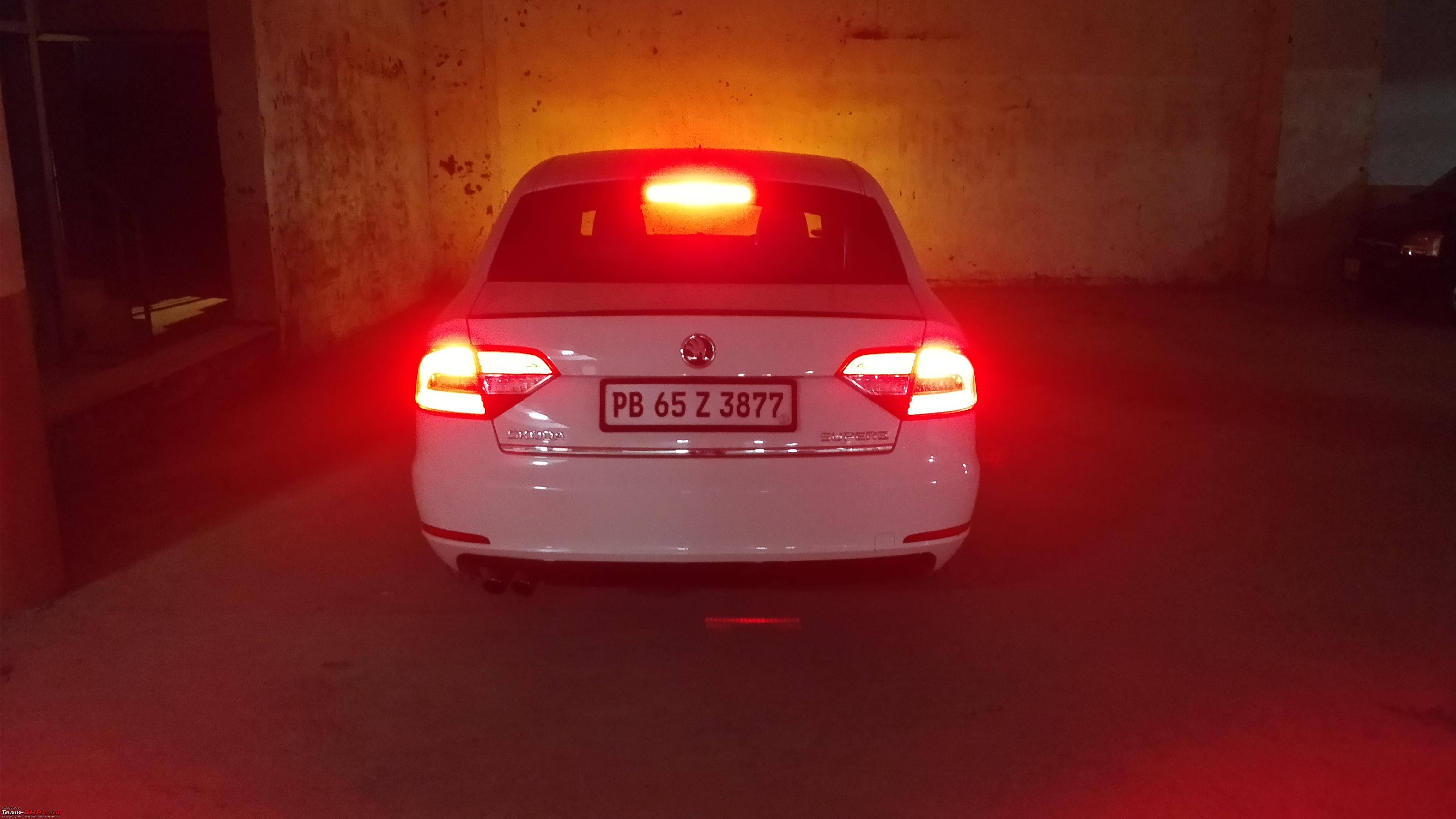

5. Use rear brake light + Rear position light to give full break light
VCDS (Vag-Com Diagnostic System) for VW & Skoda - Discussion Thread-breaklight.jpg
5b. Add Indicator+Break light option to the Rear cluster (all RED)

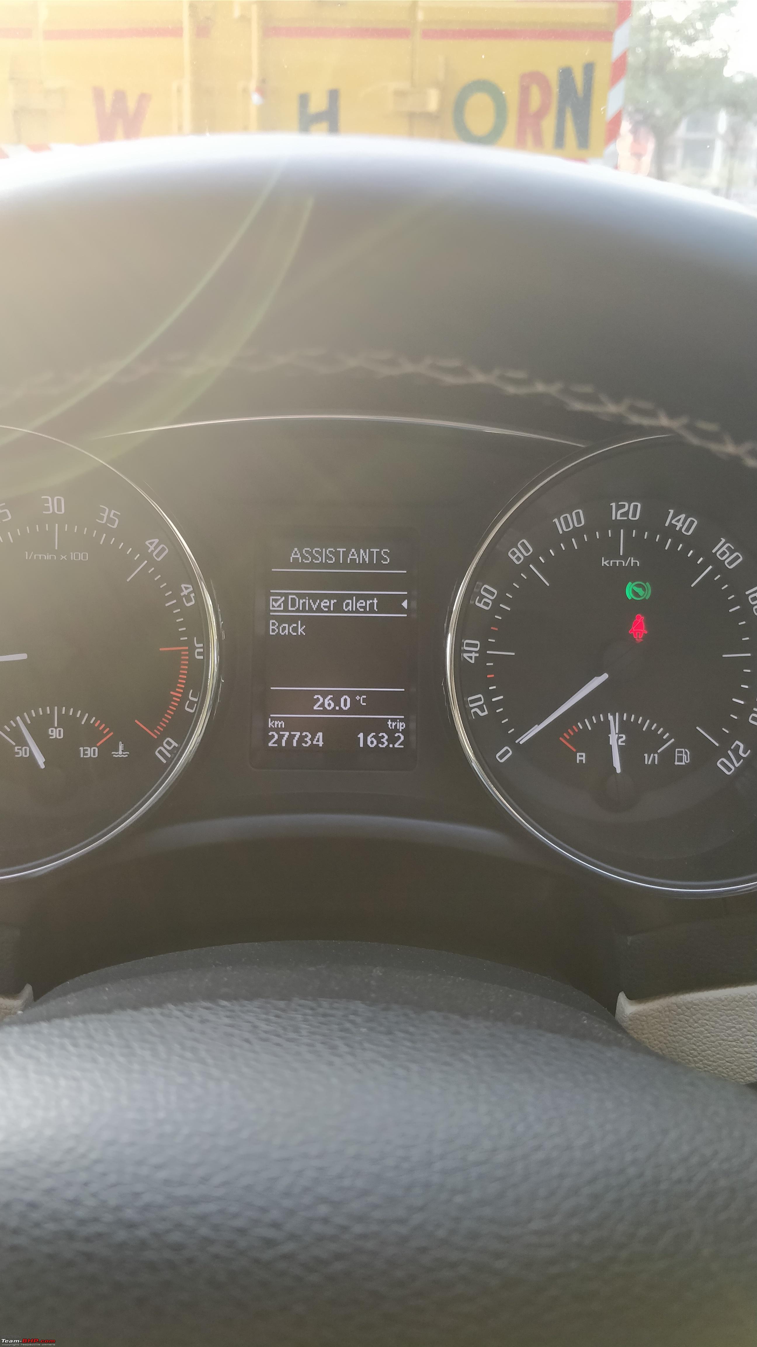

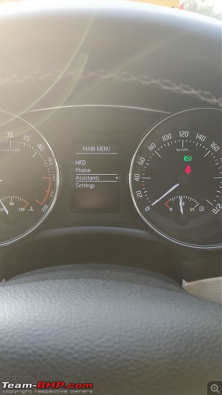

Activated the MKE or Driver Alert on my Superb (CANBUS part number: 7N0 907 530 AK). Though AK does not support MKE by defualt, i needed to flash the SW to the version which supports MKE.
Now according to the TPI, 7N0 907 530 AK SW Ver 1642 (My stock config) has a natural upgrade to 7N0 907 530 AN ver 1642 with MKE. Following steps were done in order
  1. Flashed the Canbus with ODIS with the file 7N0907530AN_1642.sgo and ran the parameter file. and
  2. Activated Driver "Pause Recommendation" in Instruments - Adaptations
Voila - here is the result:
1. "Assistant" in the CORE menu on MFD. (Note there is another Assistant menu inside settings but that is for PDC)
VCDS (Vag-Com Diagnostic System) for VW & Skoda - Discussion Thread-img_20171124_155305.jpg
2. You can switch on Driver Alert on and off
VCDS (Vag-Com Diagnostic System) for VW & Skoda - Discussion Thread-img_20171124_155307.jpg
3. Firing a test on the VCDS CANBUS module for Driver alert signal got this on the MFD
VCDS (Vag-Com Diagnostic System) for VW & Skoda - Discussion Thread-img_20171124_160311.jpg
Though i have not actually tested it on Highway runs, pre configuration, i use to get "CHANNEL NOT AVAILABLE" when i use to test fire Driver Rest signal, so i am hopeful i will get this to work,
For every one's benefit - the following Canbus support MKE by just SW updates (no need to change canbus HW)
a. Stock canbus 7N0907530AF Ver 1635 to be flashed to 7N0907530AJ Ver 1635
b. Stock 7N0907530AT Ver 1663 to be flashed to 7N0907530BC Ver 1663
c. Stock 7N0907530AK Ver 1642 to be flashed to 7N0907530AN Ver 1642 (THIS IS MY FILE)
d. Stock 7N0907530AL Ver 1642 to be flashed to 7N0907530AN Ver 1642
e. Stock 7N0907530AM Ver 1642 to be flashed to 7N0907530AN Ver 1642
f. Stock 7N0907530AN Ver 1642 - supports out of the box (may need just some VCDS coding if already not activated)
Once you flash the Canbus - you need to run the parameter files.
To flash the SW and run the parameter files you NEED ODIS/VAGCAN. cannot be done by VCDS
Again - this is for information only - try at your own risk
