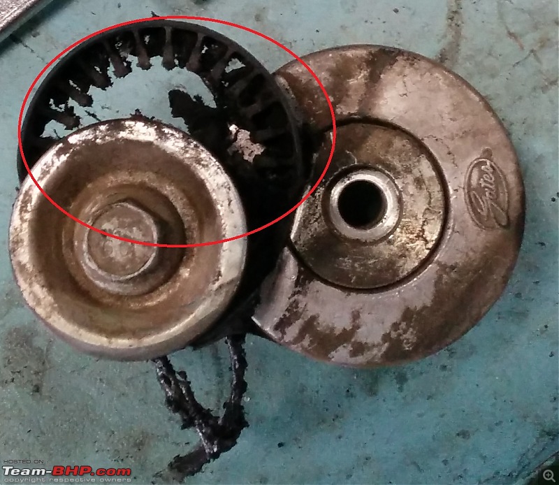

In my last servicing (40,000 KM) of my SWIFT VDI, I had told the service advisor to check the belt noise that used to be there in early morning starts.
He had it checked and advised that the noise is very slight and you can continue to drive, we will check in the next service as there is nothing to adjust,the belt is mounted on auto tension pulleys !
Alas the belt gave up which I was on my way to the market for some sunday shopping. There was a grinding noise, burning smell and the battery indicator came up. Slowly I managed to drive home.
Today took the car to the local Maruti service station which opened up the belt assembly & showed the entire plastic adjuster was shot
No damage to other parts.
Belt as well as the Pully assembly replaced. Total bill 2800 INR.
Would have been cheaper had this problem been proactively acted upon in the last service
Lesson learnt - Do not ignore those minor sounds also, you may be stuck in the middle of no where
