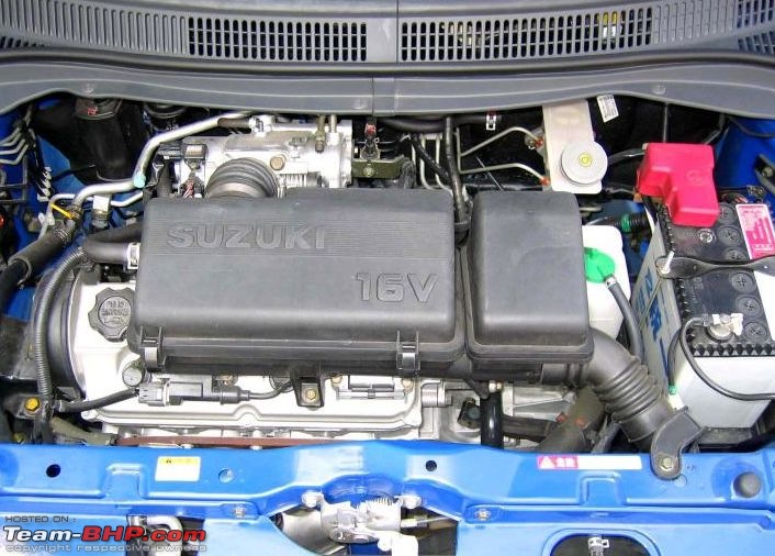

How difficult or easy is it to clean the air filter element in a Swift Petrol. Can I do it myself - note that I am not particularly good with doing these kinds of things? Can someone explain the procedure to do this & if any particular tools are required?
Also, can one get this done from one of the local HPCL petrol pump service centers - they should be equipped to do this, right? How much would it cost?
carboy is offline
Old 27th May 2010, 16:12   #145
Location: zxc
Posts: 3,395
Thanked: 727 Times
Originally Posted by Raccoon View Post
Hard to grease? How would you be able to grease them at all? Even if it were possible, how do we know what grease the manufacturer has put in? The grease that you put in will surely make some strange cocktail with unpredictable results. I'd suggest leaving it alone as long as it lasts. In any case, if they are worn, you will surely "hear" about it...
You don't just put grease on old one, you clean the bearing with diesel and then apply new grease evenly.
You probably shouldn't then, how old is the filter. You can change it, its just Rs.450/-. If its an aftermarket like K&N there are filter cleaner solutions.
If its not that old, you have to blow air to it.
PS: To get to the filter you have to open the black plastic thingy. Its just like opening a tiffin box.
If its a normal paper element, all you need a vacuum cleaner (blower). Else you could even take it to any place that has a compressor - garages/washing centers/tyre or puncture shops, etc. Sorry, don't know how easy it is to open it up on a Swift, but it should be easy enough.

Old as in 5000kms. or a year old.
yeah any smart car wash guy can clean it. He will take it out and spray dry air on it.
