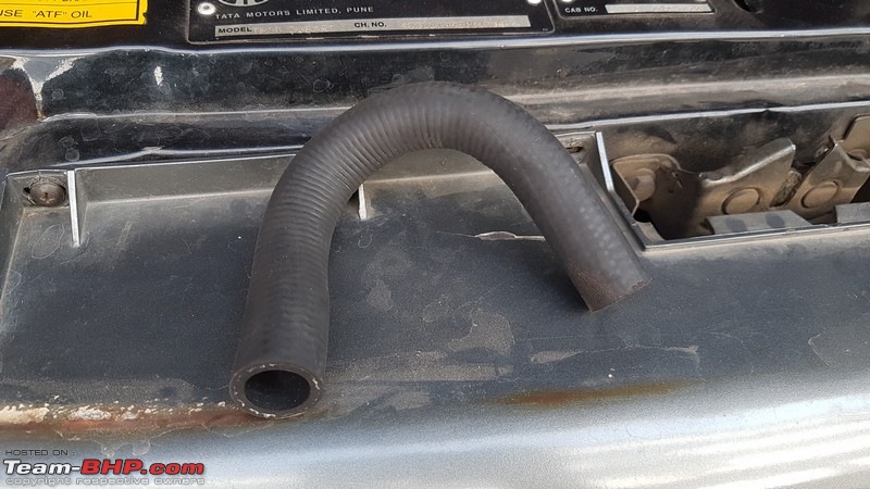

I have a strange problem in my 2008 Safari 2.2.
The symptom is excessive coolant consumption in short distances. For example, yesterday, I topped up the coolant till the upper marker, went for a ~70 KM drive and came back to find the coolant level at the middle mark. But on the other hand, I drove BLR-TVM of ~670 km a couple of weeks ago, and the drop is negligible.
This began 2 months ago, and I thought the coolant (green) might have gotten too much diluted, and got the radiator flushed and filled fresh from TASS (blue). Went on to drive TVM-BLR and the coolant drop was minimal. But with local running in BLR, the drop in level was significant.
There is no overheating (the needle stays in the middle or sometimes a tad less). There is no visible dripping. I checked the underside of oil cap and tailpipe, no deposits there of note. Coolant has not changed in color on visual inspection. The radiator cap is fresh, replaced at TASS about a year ago.
I tried Liqui Molly Radiator Stop-Leak, and it ended up giving a leaking rubber hose. Replaced it, thought that might have been the issue. Did another BLR-TVM drive, found minimal coolant drop. Then, with local running, I am again finding significant coolant drop as described above.
Any insights or experiences to share?
I had similar problem in a Ford Ikon. Minute leak which doesn't show up in visual inspection. The engine heat dries up traces of the leak. At that time a good FNG suggested that the radiator is pulled out and sent for repair. I bought a pack of JB weld Permoseal and added it to the coolant. I never had to refill the radiator until we sold the car 2 years later.
It turned out to be another rubber hose failure. This time, the outlet from oil cooler. Anyway, decided to get both inlet and outlet hoses changed. Waiting for part to arrive. Hopefully, that solves the problem.

The culprit:
The Tata Safari 2.2L Technical / Problems Thread-image00003.jpg
The Tata Safari 2.2L Technical / Problems Thread-image00002.jpg
New part:
The Tata Safari 2.2L Technical / Problems Thread-image00001.jpg
