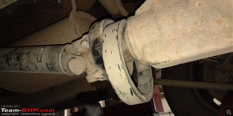

Last Sunday while driving from Mysore to Bangalore, post negotiating a series rumbler strips/humps the car started severe vibrations and metal clanging noise from the under body. Called Emergency Helpline and got the car to Urs Kar , Hebbal where it was diagnosed as a damaged TVD.
My car is a Storme Dec 2013 model, 77K driven
Quick question, is anyone aware of any known issues with the TVD ?
On the forum i can see a couple of posts where it was changed under warranty and AMC. I have written to TML and awaiting a reply on this.
https://www.team-bhp.com/forum/trave...ml#post4251864 (Ladakh'ed in a Tata Safari Storme)
https://www.team-bhp.com/forum/offic...ml#post3789659 (2015 Tata Safari Storme : Official Review)
Also want to document the support received from Mr. Raju D (Branch Manager of Urs Kar, Hebbal). He was extremely helpful considering my situation of being stranded with family and it being a Sunday
The Tata Safari 2.2L Technical / Problems Thread-tvd1.jpg
The Tata Safari 2.2L Technical / Problems Thread-tvd2.jpg
Dont think there is any predictable issue with that part. My Storme got a replacement during a service - was checked & found to be wearing out. This was may be a couple of years ago.
