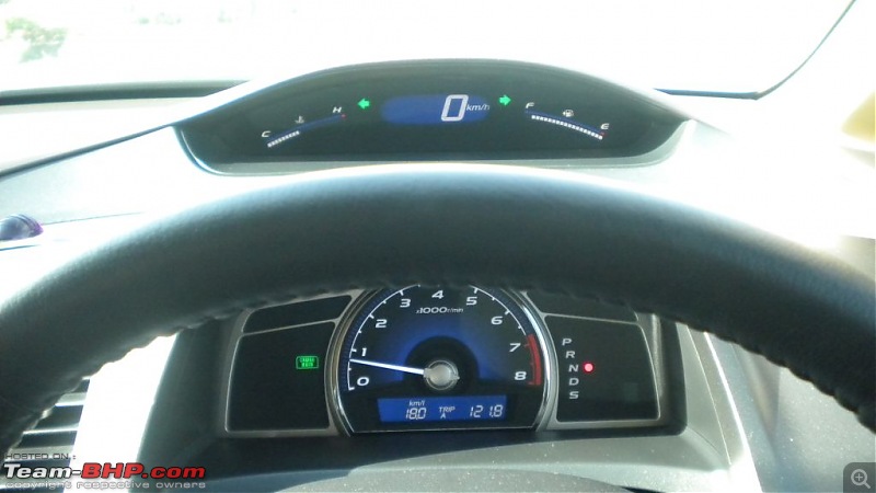

See the picture below from my latest FE drive while going on NH7 south of Bangalore. I maintained the RPM below 2000 whenever possible and speeds below 100 kmph throughout the 121 kms. I was using a/c 100% of time and had 3 passengers in the car with tyre pressure at 34 psi.

I roll down the windows.
And to top that you have an A/t , that's cool .18KMPl on the display and i guess the real world figure would be around 16.Good enough for me.

That's great mileage. But Bangalore-Selam gives awesome FE figures always. I couldn't believe, my Pre-NV Palio gave 19.5kmpl on this stretch. Attribute this to the continuous descent from Bangalore down the Deccan plateau.

You are absolutely right on the factor of the slow descent towards Salem contributing to the high FE. In fact I tried to emulate a similar feat on my way back and it was almost impossible for me to maintain the RPM below 2000 due to the slow climb from Salem. I could not get my FE past 15 in this direction.

Nice one, vasoo! I'm amazed you managed to control yourself for 121 kms, though!

I think it's easier to get better F/E on the AT on a highway, especially if it's a divided highway (or an ultra-wide 2/3 lane undivided one). Consider that in 5th, the MT does 80 kmph at 2k rpm whereas the AT does 100 kmph.

are you saying @ 2krpm the auto will behave as in 5t gear in MT at 80-100 kmph ?

It depends. If one is cruising on a highway, at 2k rpm the auto will slowly shift to 5th (and therefore, behave similarly).
But the point I was making was that the AT has taller gearing. In 5th, the auto does 20 kmph more at 2k rpm than the manual. This taller gearing endows the AT with better F/E when cruising on the highway, which is quite counter-intuitive as generally autos are worse at F/E than manuals.

Hey vasoo, what a coincidence. I too did some hyper-miling last weekend on ECR from Pondy to Chennai (half way only though) and maintained speeds between 70-80kmph and was pleasantly surprised to see the MID show 19.7 kmpl. If not for my impatience to stick to those speeds, I am sure it would have touched 20 kmpl. I had two adults, 2 children and 1 pup in the car with 33psi on the tyres.
