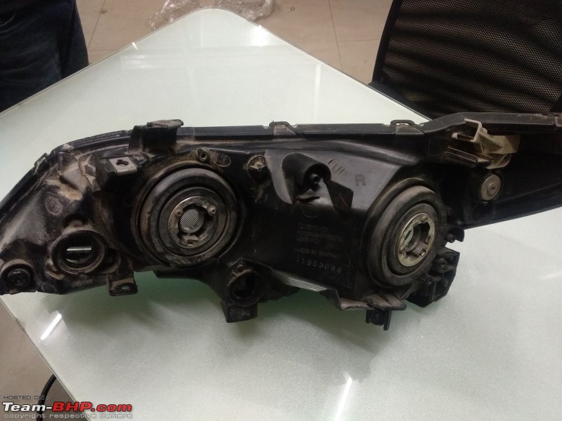

Does anyone have an idea where are the headlight level adjusting screws. My right beam is a bit high and t requires to be lowered. However I can't find the screws for adjusting the level.

These are pictures of my old headlamps that I had replaced on my civic.
Fixed beams I guess. The only leveling is for the headlight beam angle.
Honda Civic : Maintenance, Service Costs and Must dos-civic1-800-x-600.jpg
Honda Civic : Maintenance, Service Costs and Must dos-civic2-800-x-600.jpg
Honda Civic : Maintenance, Service Costs and Must dos-civic3-800-x-600.jpg
Honda Civic : Maintenance, Service Costs and Must dos-civic4-800-x-600.jpg
