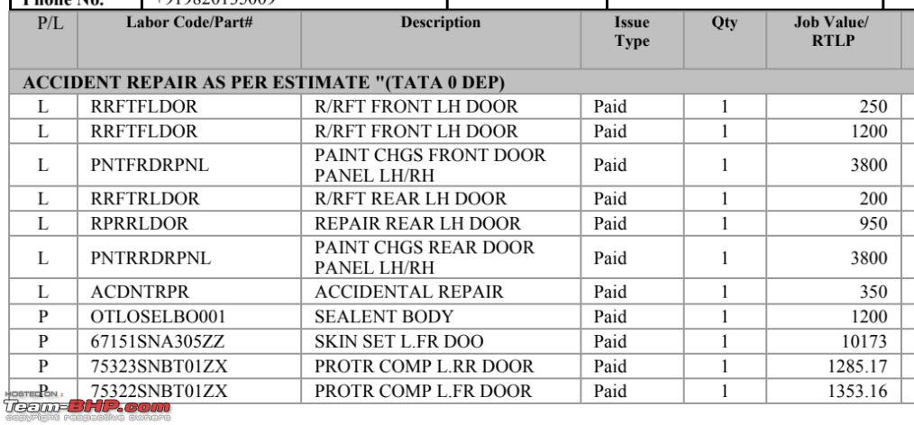

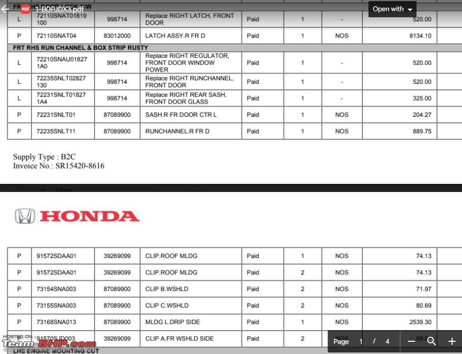

Hello CzechItaliaMoto,
Thanks for your guidance on the Civic purchase. That one I have decided to skip since its a very old vehicle (2006) and I am not sure if the reported issues were ever fixed.
I have found another one with a dealer and it is a 4th owner car. The car is low running - 31K Km from 2011 with a full service record till 08-2021. Between then and now the delta on ODO is only 2.4K Kms which should be ok I suppose. But in the history I see 2 accident repairs and a lot of parts where changed. I am attaching a summary of the same here. If you can guide me on this, let me know. I am yet to see the car though.
While the rear bumper replacement seems to be ok (could be some rear hit) what is worrisome for me is the full door replacement on one side along with other important parts including engine mounts, tie rods and related components in the steering rack as well.
Appreciate your thoughts on this.
