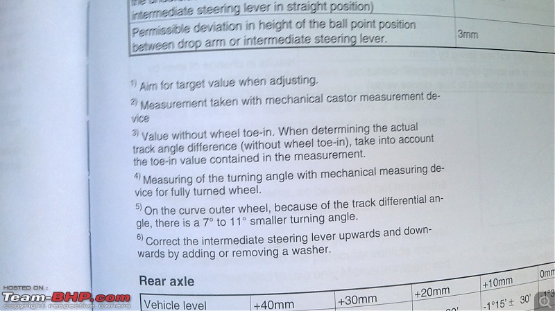

No need to go to ASS. I am uploading the Charts for the Wheel Alignment for every ones benefit.
