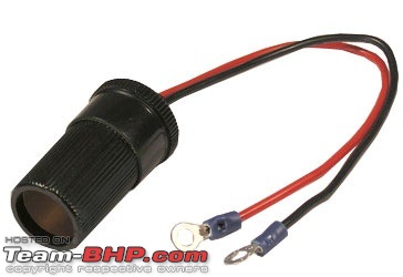

Or get either of the below. Costs around Rs 200/.
If you are willing to tap a power source and splice the wire, well and good. And if you are against cutting and splicing wires, get a fuse tap.
The Dashcam / Car Video Recorder (DVR) Thread-lighter.jpg
(image courtesy - google images)
The Dashcam / Car Video Recorder (DVR) Thread-1-carcigarettelightersocket.jpg
Go down to your nearest FNG. Get them to connect the socket to a power supply that comes on with the ignition, or tap a fuse for the power, using the fuse tap. Connect the charger to the socket. Bind the joint with insulation tape to hold both together, so that it does not slip out. Tuck the whole thing behind and under the dashboard, and secure it using cable ties. You will be able to find a strong securing point somewhere below the dash board.
This is assuming that you have already run the wire from the camera through the roof lining, A pillar and then down towards the socket.

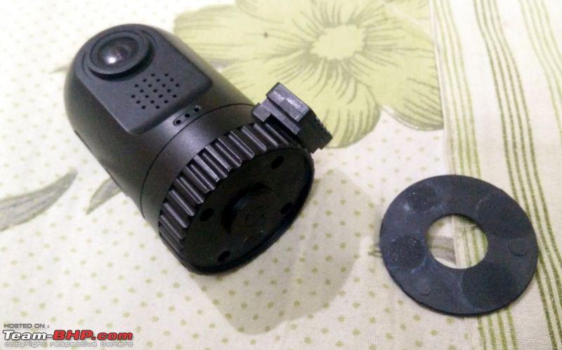

So the batteries on mine and few other friend's mini 0805 have died. Camera turns off immediately and date/time does not get stored.
I got a few new batteries for them and swapped the batteries.
Specimen undergoing the operation
The Dashcam / Car Video Recorder (DVR) Thread-01.jpg
Use a sharp tool and pry off the round cover. Its held on to the cam using 4 blobs of fevi quik.
The Dashcam / Car Video Recorder (DVR) Thread-02.jpg
Take off the 4 philips screws and pull out the ribbed plastic portion. The GPS/mount ring will slide off. There will be a metal ball dont lose it!
