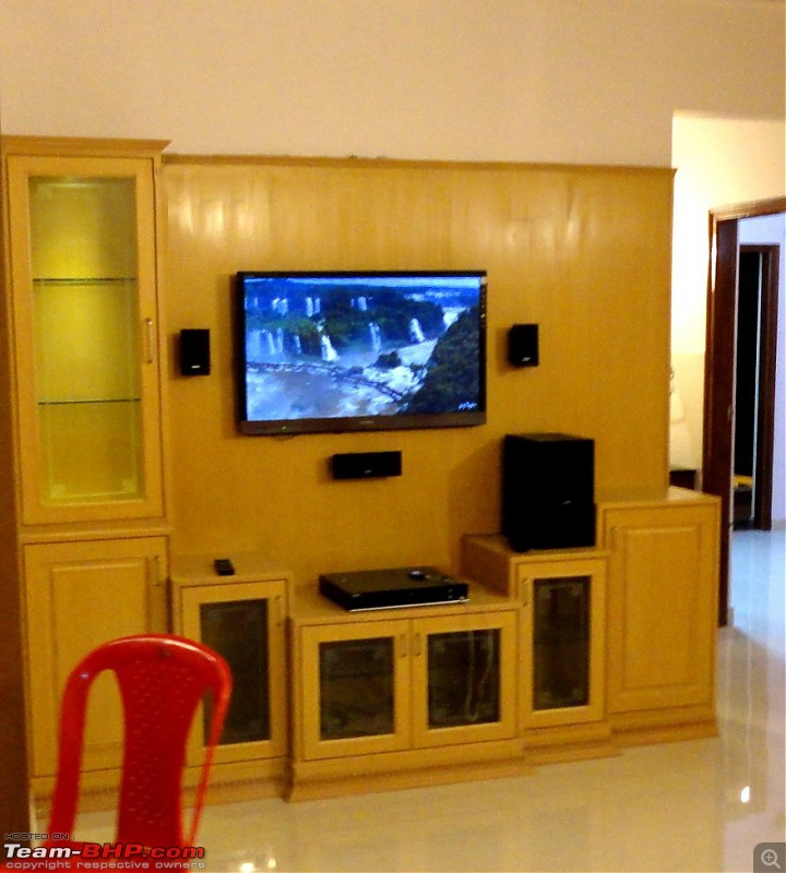

If you have a wall unit, you can always route the cables behind the wood sheet. In case you have a fixed wall panel, or mounting directly to the wall, the cables will spoil the look a bit. In case you are getting the woodwork or the masonry done, I suggest you to get a one inch Dia PVC pipe running from the point of mounting the TV till the bottom of the wall, or a place where you plan to keep all the other equipment. You can route cables through this pipe and it will be completely concealed. Here is a WIP picture of our apartment setup. Its completed now but things are lying around and hence not picture worthy
I was specific about this thing, as cables running up would not at all complement the looks. Also, another problem I faced with the mount provided with the TV was that, the clearance was so less, I couldnt plug in any pin to the rear of the TV. In the last moment, I got a portion of the panel caved in so that the HDMI pins can sit inside the cavity. Also, in order to change any pin in the rear, I have to unmount the entire TV. Ensure you have a mount that can provide good clearance so that you can at least plug in cables in case your TV has IO ports both in the side and rear, as mine. The mount provided by Sony is designed well, however, I was given a mount free by the dealer.

Thanks Audioholic, I was thinking of the same idea (Wall paneling) too, but wondering if there were any mounting options that help to streamline the wiring. I think the paneling will have to be 1 to 1.5 inches out from the cemented wall, for routing cables to all the input/output equipment, below/above the TV.
I am looking at HX750 and think the HDMI ports on this one are on the sides of the TV, so connecting the cables should be easy. Which model do you have that caused the inaccessibility to connections and leading to the cavity in the paneling?

I have 40EX520. It has ports both at the rear and side. Rear has three HDMIs and other video inouts. Side panel has one HDMI, USB, audio out and Vga. Even the side ports are difficult to access, as clearance between TV and wall is just three centimetres.
The thickness of the panelling is two cm. However, the pipe is embedded in the wall itself.
