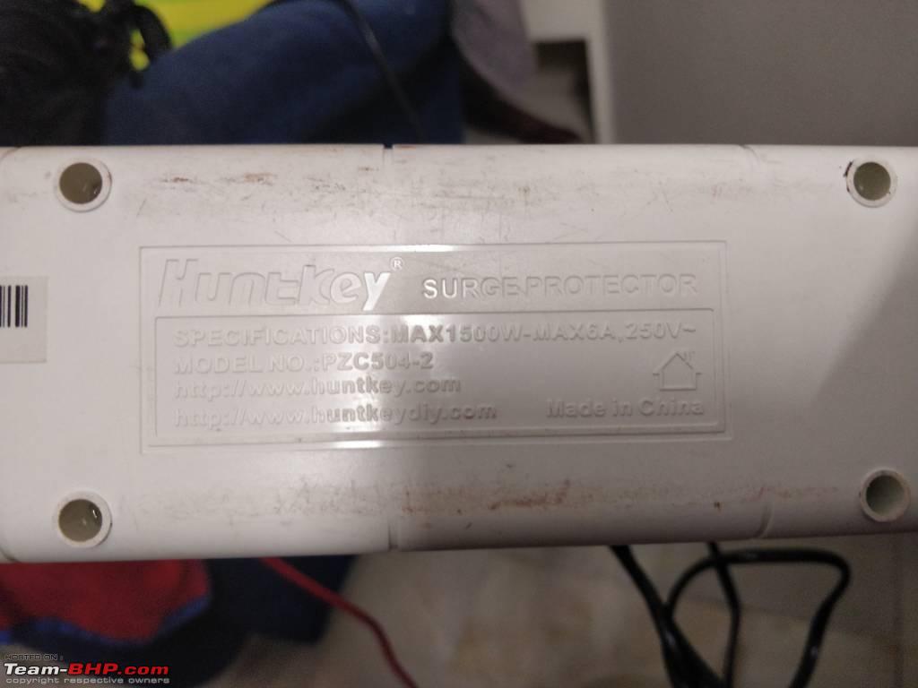

Originally Posted by archat68 View Post
I have Huntkey and I opened it, there is nothing inside it in terms of surge protection.
This is what the product states.
Also gives Insurance upto 1Lakh IIRC . I'll check mine when I'm home and post a photo too.

Re: The Home Appliance thread
I have Huntkey and I opened it, there is nothing inside it in terms of surge protection. It is a simple power extension strip.
It will be a capacitor and inductor nothing else inside.
Vid6639 is offline
Old 10th June 2020, 15:45   #7871
archat68's Avatar
Posts: 905
Thanked: 642 Times
I know. I have quite some knowledge about electronics about a hobbyist. There is nothing, the wire is directly connected to the sockets.
archat68 is offline

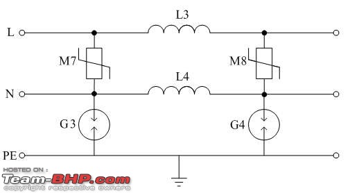

Difference between a spike arrestor and surge protector.
Spike arrestor : Typically a LC filter circuit. When a spike occurs, the inductor opens and the capacitor discharges to GND.
Surge protector : Typically a Varistor ( Metal oxide ) with a GDT (Gas discharge tube) to the GND. When a surge occurs, the Varistor shorts and the GDT starts conducting the excess current to the GND.
My guess is that the chinese have got the name confused.
srini1785 is offline   (1) Thanks
