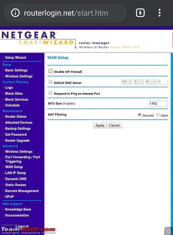

Originally Posted by sandeepmdas View Post
Which router model is this? Did you look at WAN setup?
Yes, i did look into WAN Setup as well, but did not find any option there.
PFA the WAN Setup options and also you can see the router model details.
Here's the user manual for this router:
https://www.downloads.netgear.com/fi...UM_14May08.pdf
You may want to watch this video and upgrade the firmware (ensure uninterrupted power supply when you do). Notice wireless repeating function on the side menu under Advanced > Wireless Settings in it; this is apparently missing in your router.
After that search for wgr614v9 repeater in YouTube and follow the video advisors.
I downloaded the firmware and upgraded my router. Now, i can see the repeater option. I following the instructions given and it did not work. When i tried to connect to this router, it is not able to obtain the IP address. As you mentioned, it is definitely 'trial and error' method. So I will try again tomorrow and i am hopeful of making it work.
Thanks a lot for your help.
