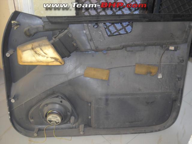

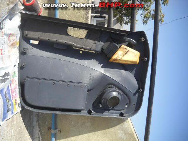

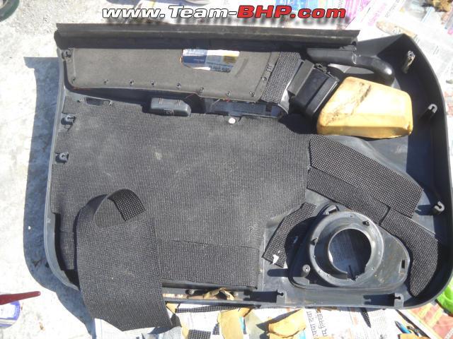

Finished front doors DAMPING of my Safari today. Materials used were:
1) Fevicol SR998 (140 INR for 1\2 liter)
2) -100 grit Sandpaper (2 Rs each, 5 of them)
3) Yogamat (one used, specs are 5x2.5 feet, costed 350 Rs)
4) Paint Brush
5) Cloth washing brush (for washing the door pads).
6) Door clips
The result is good I must say that the front is almost noise and rattle less. There are some squeaks which would be taken care of. I did'nt do the rear as the time taken for front door pads (with fitement) was some 5-6 hrs and I was damn tired. Would have done the rear and doors tomorrow but I have to go out of station. Will finish the rest work as I come.
Pictures are as below in sequential order:
1) After removing, see how dirty is it:
2) Essentials like door light and speaker removed for washing the door pad:
3) Door pad washed and than allowed to dry in sun:
4) After damping:
