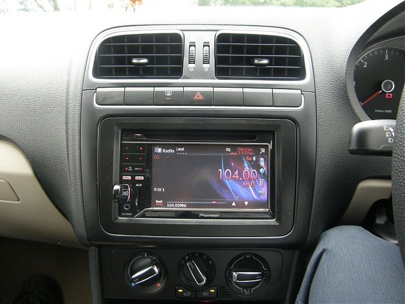

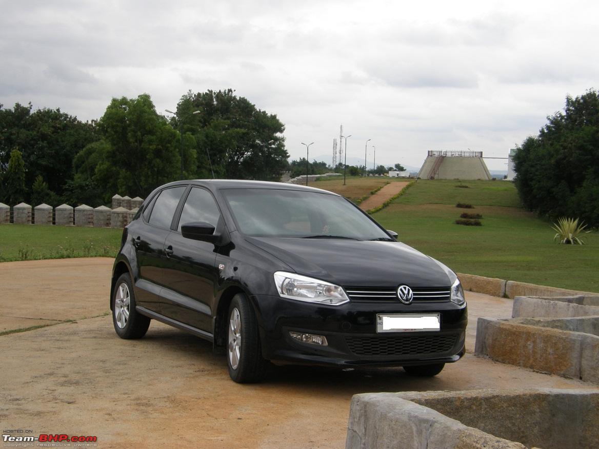

Some pictures taken after second service and Diamond-Bright interior and exterior cleaning...
