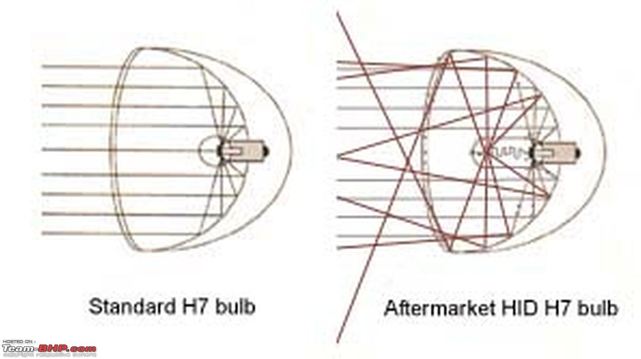

HIDs should not be used in headlamps that are designed for filament bulbs. The reflectors unless designed for HID bulbs, will scatter light in every direction. The problem is the focal point of the bulb. The reflector is a parabolic mirror, whose point of focus resides the standard headlamp bulb. A HID bulb’s light is not made at the same point as the filament bulb – which means that the parabolic mirror is not channeling the emitted light as a parallel beam of light, but one that is potentially widely scattered. Poorly focused light like this will project well beyond the designed beam dispersal pattern, potentially causing glare and dazzling on-coming traffic.
A reflector designed for filament bulb showing scatter of light from filament bulb as well as HID bulb
Auto Lighting thread : Post all queries about automobile lighting here-incorrect_focus.jpg
HID manufacturers had come up with a solution to this problem so that existing cars with headlamps designed for filament bulbs can retrofit HIDs in the reflector type headlamps without the uncontrolled scattering of light and dazzling of on-coming traffic.

One is a plain HID bulb and the other with masking in place to prevent more than 1 hot spot which gives the single hot spot effect of a filament bulb. AFAIK even these are not legal but at least these will not blind the on-coming traffic like plain HID bulbs without the masking. This is why even the fog lamps dazzle when fitted with HID bulbs.
HIDs are best used with projectors. But again if the aftermarket projector is not of good quality, it might harm fellow motorists as well as not be efficient enough.
Well, I don't use HIDs in reflectors myself or encourage using it, but thought of sharing this info hoping that it might create some awareness as to where the real problem lies and what should be taken care of, for those who want better light output or HIDs.

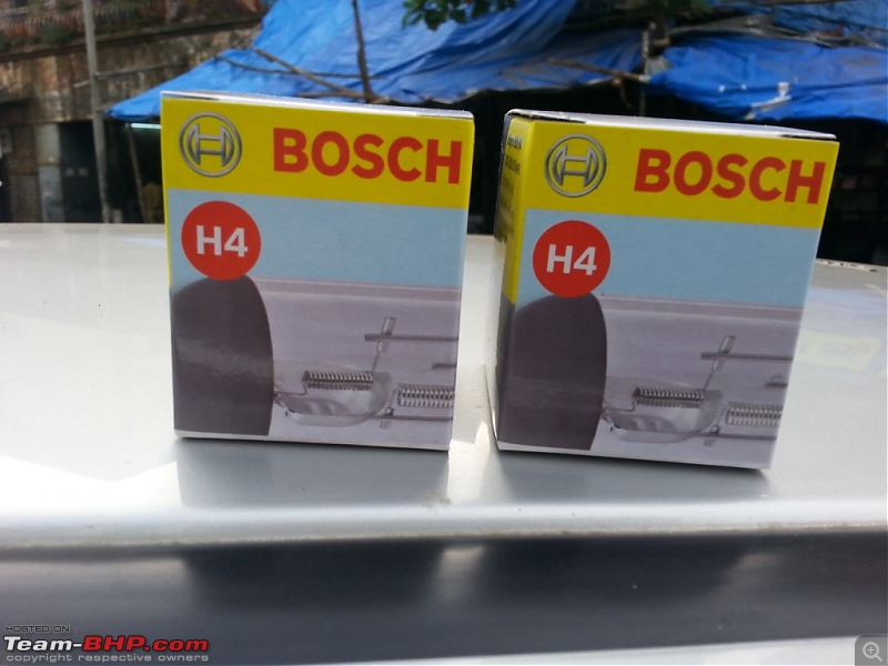

I put these in my mom's Alto yesterday to replace the Philips Rally 130/100 which lasted well over 2 years (Infact 1 bulb is still working which I've kept as a spare). The Bosch obviously are no match but they're ok. They're also shorter in length than the Philips.
I've personally never used anything apart from the Rally 130/100 in all my cars till date so can't compare these with the Rally 100/90. At 160 bucks for the pair I'm not complaining.
