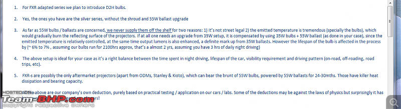

Originally Posted by Dodge_Viper View Post
Hi Sridhar
Thanks for sharing this. I am in exact same situation as you were. Dropped the idea of fitting aux lamps.
Few questions:
1) Which make are ballasts and bulbs?
2) You mentioned about sizes in projectors. I agree sizes are for different headlamp assemblies, but does this impact the throw of light?
3) On their site, they have mentioned Genome gold, silver and basic series. Which one is yours and what's the difference?
Got a clarification from Joy. See the image below:-
Auto Lighting thread : Post all queries about automobile lighting here-capture.png
First dealer who understands technical issues & gives a coherent & considered opinion!!

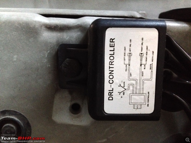

Got good quality ( 5 x Cree 1W LED ) DRLs from Karol bagh a couple of days back for about 900 bucks and planned to install the same by myself.
The DRLs came with a high quality harness and a mounting kit but without any controller and hence could be installed either by tapping the ACC or by tapping the headlight but i want to replicate the way DRLs are supposed to work ideally. Apart from the DRL connectors on the harness there was a white wire which turns the DRL off if it is connected to +12V.
I searched ebay and i came across chinese make DRL controllers which are available for sub 10 USD but ordered a good quality one which was about 21 USD. These controllers connect to the car battery and have relays which activate when the battery voltage is above 13.5-14V (when the alternation is working /engine on) and deactivate when the battery voltage is less than 12.5 volts (when engine is off).
The DRLs will be connected to the output of the controller and the white wire will be tapped to the fog lamp +ve using a 3M scotchlock self-stripping tap connector. I used the fog light +ve to turn the DRLs off as i wanted an option to keep the DRLs on if required at night. So the logic works like this : headlight on + fog light off = DRL on and headlight on + fog light on = DRL off.
I started the installation on a Sunday morning at about 10:00 am and finished at about 4:00 pm. Attaching some pictures of the DRLs, controller, DRL fitted below the Tucson fog lamp cover and install complete pics.
