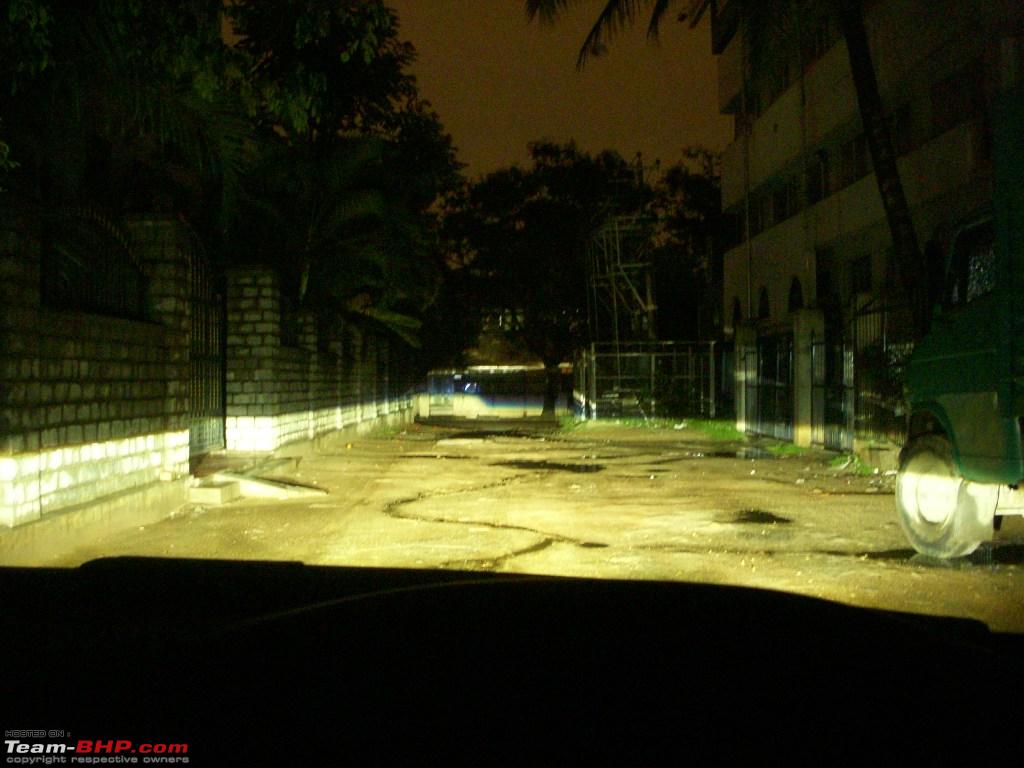

I have managed to install the 3000K HID fogs in my Civic. The experience is at
http://www.team-bhp.com/forum/test-d...ml#post3245112
sgiitk is offline   (1) Thanks
