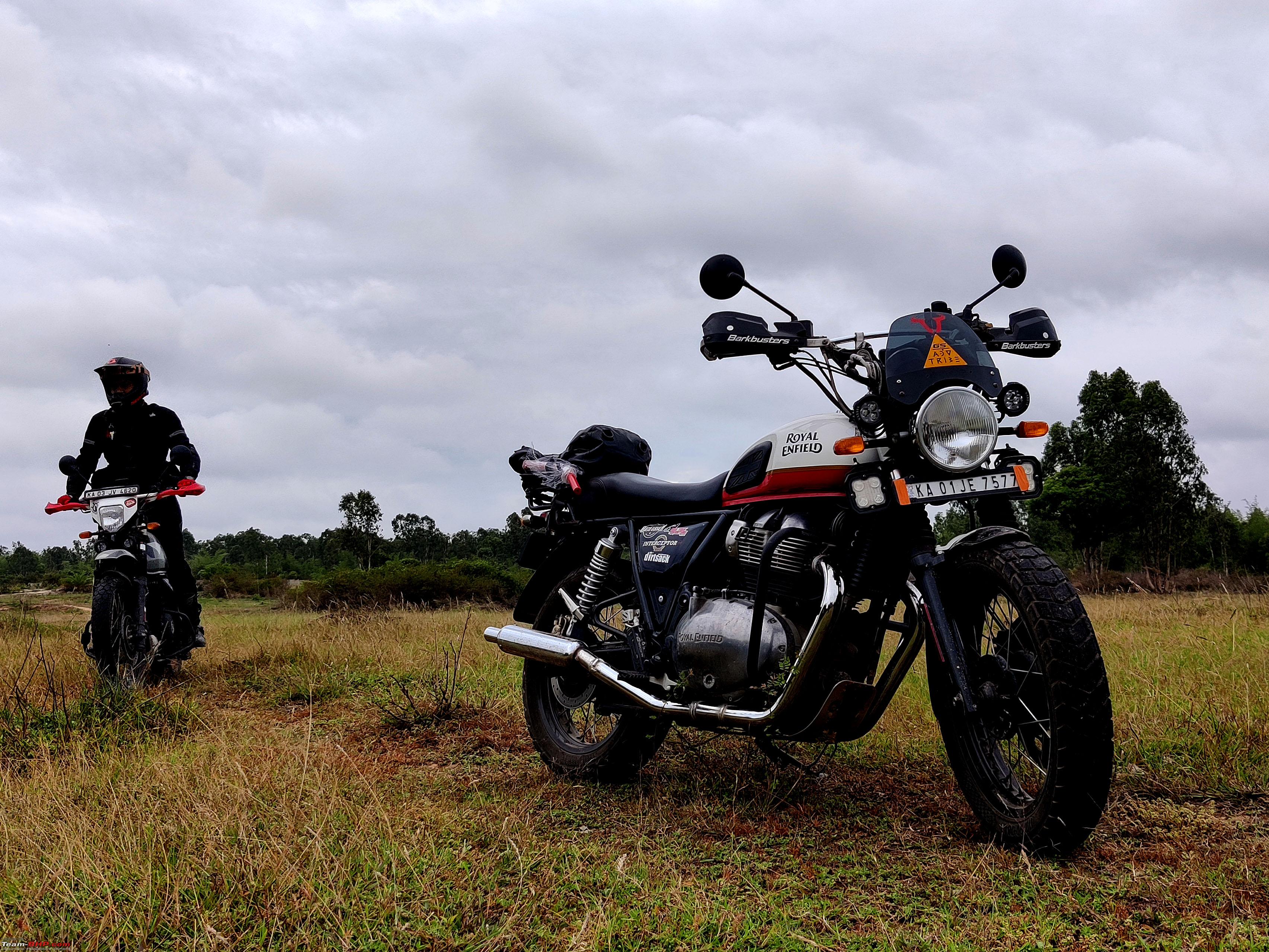

On another note, got a new handle bar installed. This handlebar is made by Zana, but i made some changes to all the angles and reduced overall width to try and make it suitable for my usage. After some adjustments, am happy with the outcome.
Have tried various handlebars in the past including stock with riser, without riser, Art of motorcycle bar with and without riser, Bikology bar with riser, and now this modified Zana bar seems to serve the purpose well which is upright riding posture yet sporty stance, and can easily stand and ride. (also thanks to towered pegs). Sharing some pics of a morning ride last weekend and handlebar fitment the same day.
