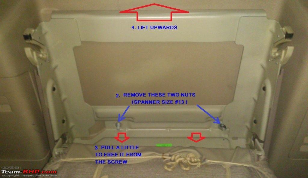

Removing the rear seats
No rocket science, but still:
To remove the rear seats:
1. Flip the seat down to expose the Frame
2. Remove the nuts. Will need spanner #13
3. Pull the lower end of the Frame to free the frame from the screw-threads
4. Pull seat from the top.
Tata Safari Storme : Official Review-seatframe.jpg

Removing the seats has been a big help in freeing up space at the rear for long trips. Normally this would not have been a problem, but the seat covers on my seats are a little thick, and cause the seats to protrude into the luggage area even when folded.
Note:
Seats are specific to each side. Seat from left side wont fit in on the right side & vice-versa.
Same issue noticed here. Had to get the snap-on buckle straps lengthened so that the two ends could meet - for the same reason. When folded, the original lengths were falling short.
