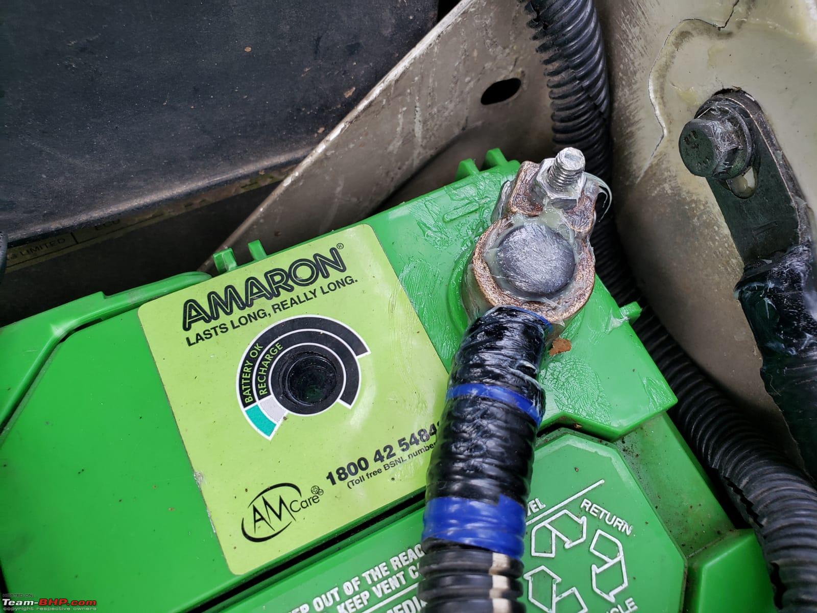

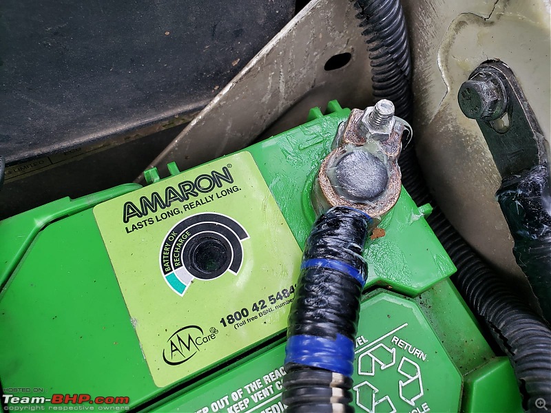

Experienced an issue with the Starter today.
I normally switch off the engine when the wait time at a signal is long, and did so today a couple of times when on way to office. However on the 3rd instance, the Storme refused to start. I was in the right lane of a divided stretch, and traffic busy. Tried to start, but when it didnt, I let the Storme move forward on the sloping road, and managed to bring it to the left side before starting the problem solving process. Thanks a ton to all the other motorists who realized there is a problem, and let me move across from right side to the left.
Electricals looked ok - stereo, power windows both work. However on cranking, there is no sound that one would hear from the starter motor. Absolute silence.
Removed key and re-inserted, tried again. No luck (has worked once before in an instance long back)
Called Exide Batmobile who raised a paid service request. The person came after an hour, and we tried to jump-start by connecting the spare battery using the jump cables. This too didnt work.
The Amaron battery showed health status green, and the cells looked to have full level of water in it, despite the 2 years of use.
We managed a push start and then I went directly to TASS. My regular mechanic checked it further.
Relays were good. However, the culprit turned out to be a loose clip on the cable connecting the battery to the starter motor. At the starter motor end, there are two types of connectors on this cable: a clip or a regular nut to hold the cable down. The problem noticed in my Storme was because it has a clip type connector.
We tried starting a few times there, and it worked fine. Came home and checked it again after some time. Thinks look fine for now.
He also checked the battery for voltage levels, and it looks good. The starter motor did not have any powder/residue on the surface either.
So fingers crossed that the problem does not occur again.

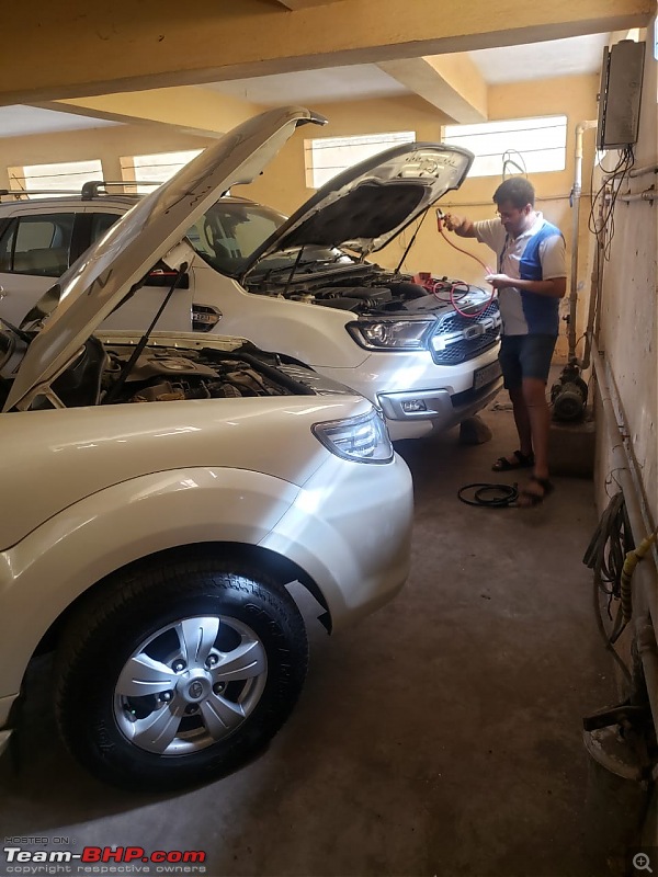

Btw is it correct that the Storme cannot be jump-started - the battery in the vehicle must be good. In other words, if the battery goes dead, then we need to either charge that battery outside and put it back in, or place a good battery in the vehicle to make it start. Has anyone else faced this ?
I have dhakka started my car several times. Couple of times in 2019 I tried jump starting it with my grand i10, It didn't work, so I pushed the car and put it into gear while cranking at the same time, it worked.
But I remember trying with my Honda city diesel , and it worked.
I recently went to help an endeavour which wasn't able to start on it's own.
We kept the cars connected for half hour, and tried jump starting, nothing worked. Had to get a new battery for the endy.

Couple of times in 2019 I tried jump starting it with my grand i10, It didn't work, so I pushed the car and put it into gear while cranking at the same time, it worked..
Using an i10 will not work. That i10 would have may be a 45 Ah battery ? We use a 80Ah. The supplying battery needs to be of at least same rating as the discharged one.
So looks like these big guys need a battery replacement and the jump start wont work. Wonder if any one has tried in XUV / Fortuner.
@Ph03nix - looks like the person who told me was correct. Something we need to remember.

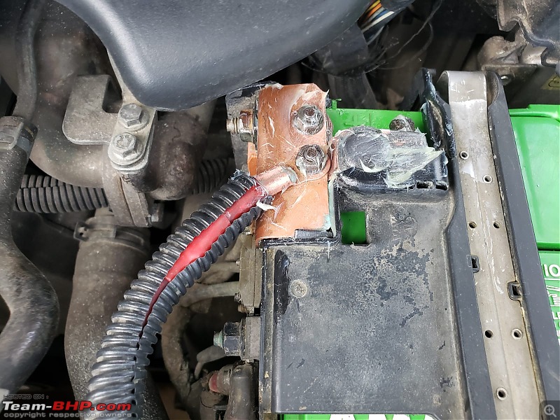

First two jobs done on the car after crossing 1L kms
  1. Wiper linkage service
  2. Battery Terminal cleanup

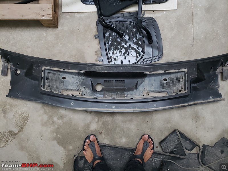

Popped off the top of the cowl, cleaned it up. This was the second or 3rd cleaning in 2 years, with a closed parking, this still accumulates a lot of trash
Tata Safari Storme : Official Review-dirtycowl.jpg

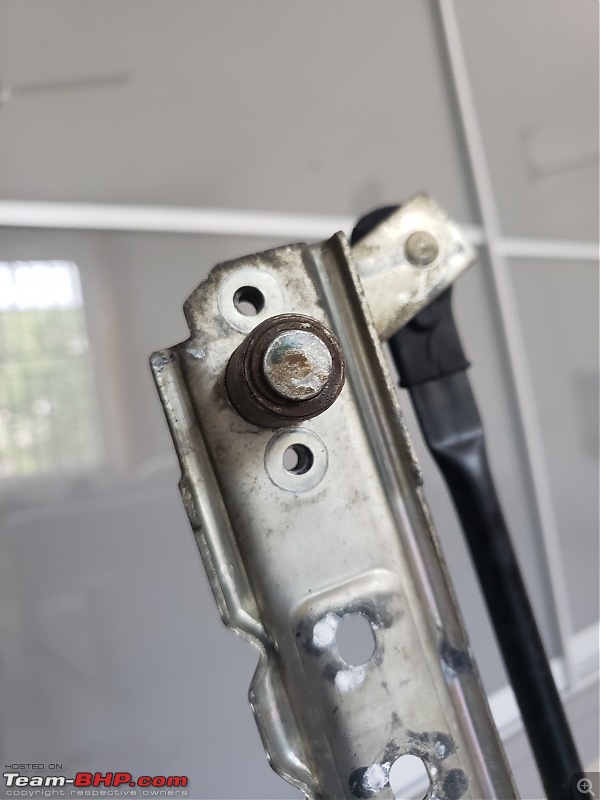

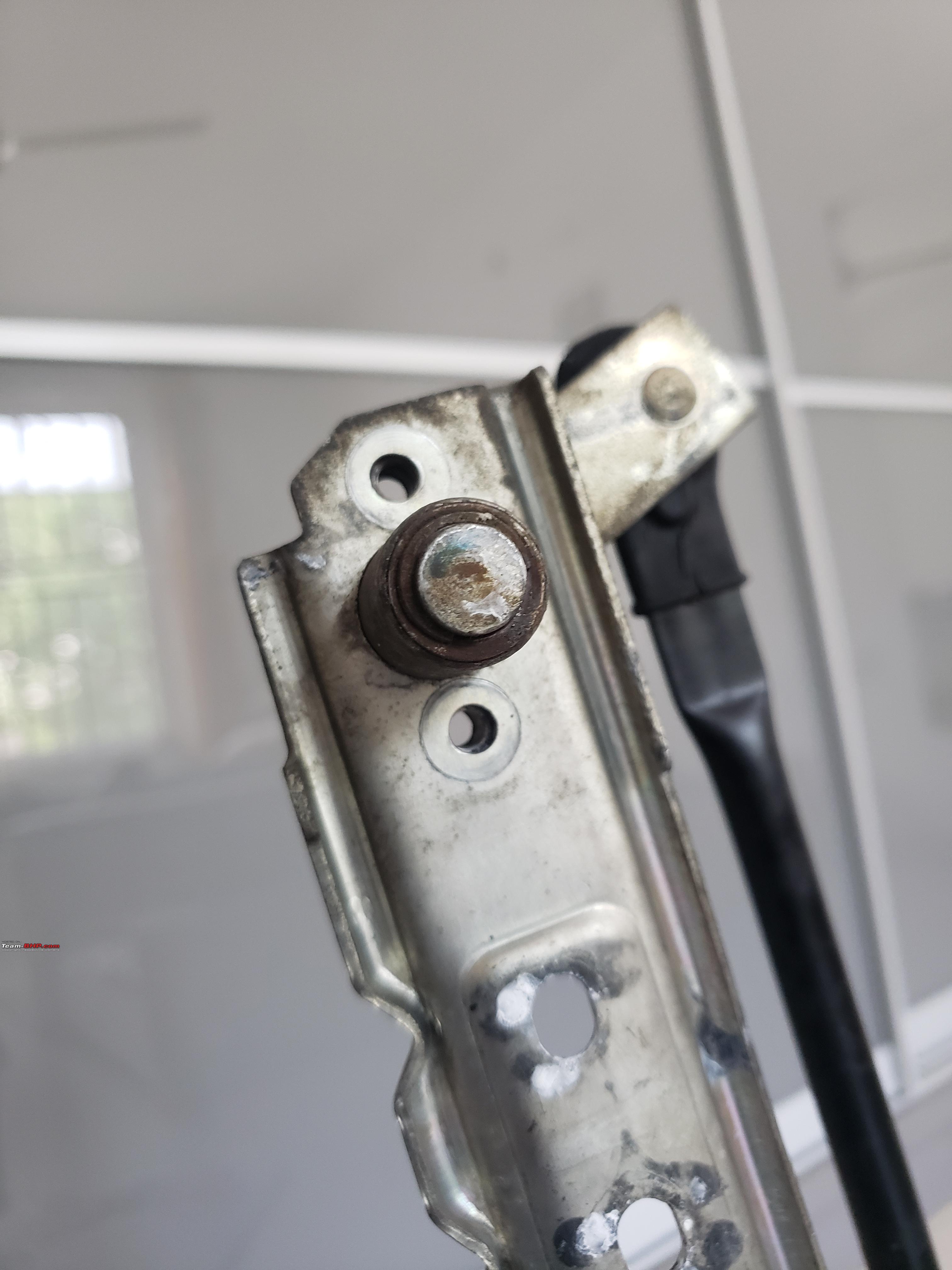

This is the joint which has the swivel for the linkage. You can see the Rust at the joint, it had caused the entire assembly to seize.
Tata Safari Storme : Official Review-swivelrust.jpg

This is the backside of the spindle on the assembly.
there is a small C clip if you look closely, this holds the spindle inside the space in which it rotates.
Tata Safari Storme : Official Review-backside.jpg
This is what the spindles look like.
The spindle rotates inside the hollow cylinder, there was rust formed and the spindle stayed locked inside the space. The spindle has a small extension, which move when the spindle rotates, one was jammed completely, I tried hammering too, nothing helped, The other spindle was tough too, but was rotation about 15 degrees each way.

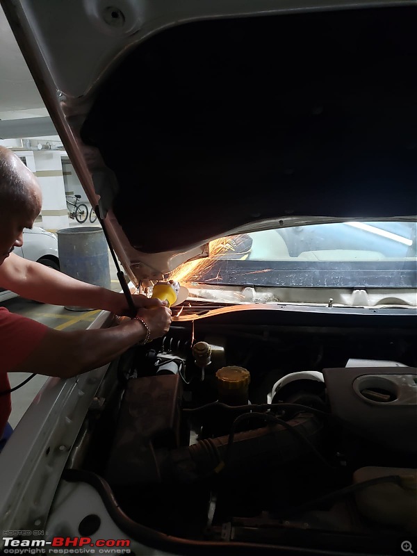

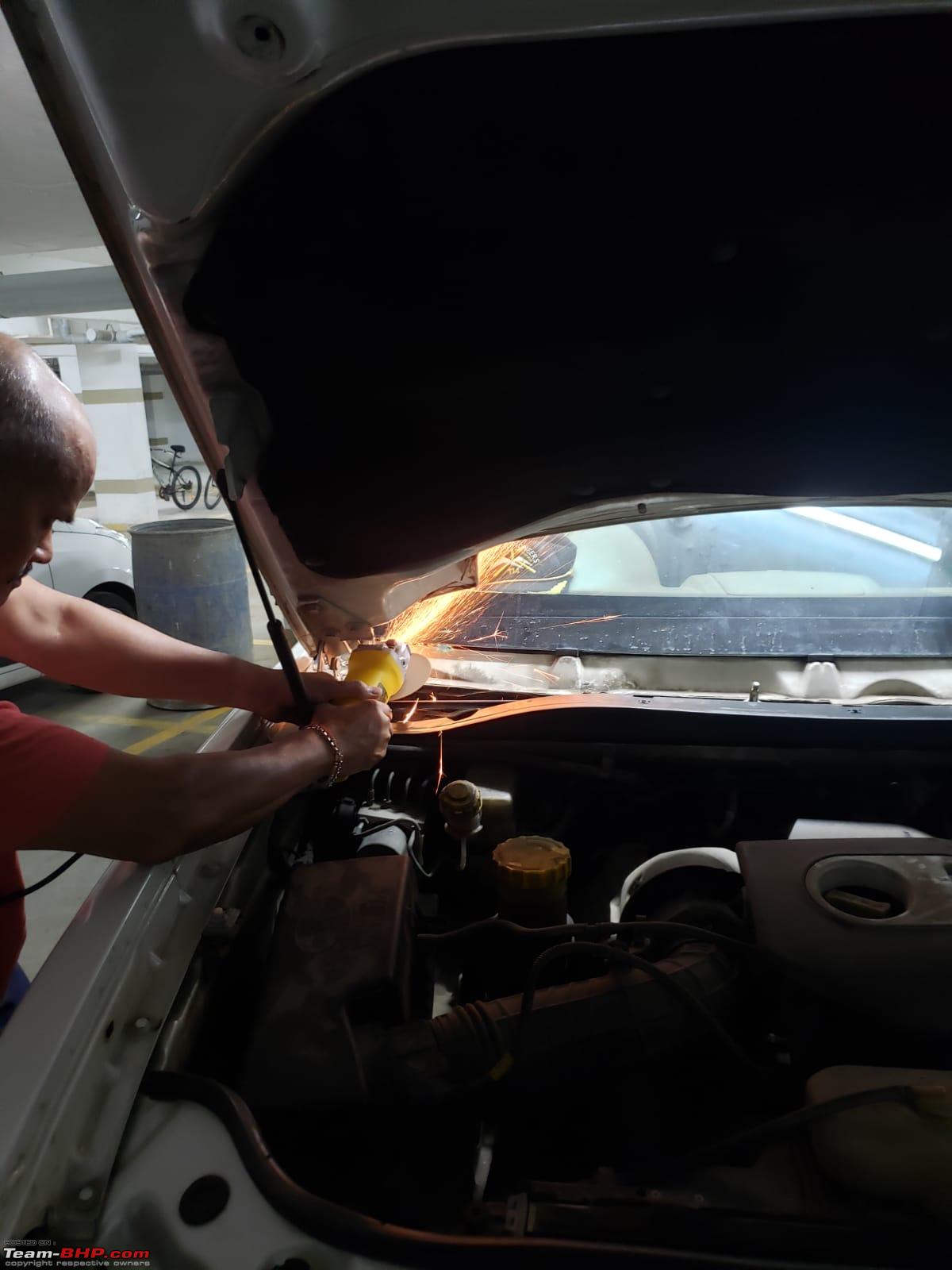

Thanks, @Vixit. How difficult was it to pull out the wiper motor + arms ?
The guy here tried quite a bit, and finally used a hammer and sharp object to move away the surrounding metal (especially in the center /below the middle point of the glass) to get it out.

Also cleaned up the battery terminals.
cleaned and put new insulation and tape on the ground wire, greased the terminals with some generic bosch lithium based grease.
This was the terminal before
Tata Safari Storme : Official Review-terminal.jpg
After cleaning and greasing, took a lot of effort.
Tata Safari Storme : Official Review-whatsapp-image-20221002-3.21.12-pm.jpeg
The ground
Tata Safari Storme : Official Review-whatsapp-image-20221002-3.21.12-pm-1.jpeg
It was extremely easy pulling the assembly out,Wiper arms too are just one bolt on each arm.
did he try attempting all the repair work while the assembly was still on the car?
Only difficult part was getting the spindles out of the surrounding metal. Initially I didn't even see the C clip holding the spindle, a member of Tata safari whatsapp group Harish told me about it. But even after removing that C clip it was jammed tight. It was so tough that I had given up and used the car like that for 2 days thinking I'll just buy new.
Oh I used a hammer too!
And damaged the thread on the spindle, When I was putting everything back, the last bolt which holds the wiper arm down was not tightening onto the spindle because of the damaged thread. We had to bring out the angle grinder and shave off one thread from the top. Dad to the rescue , he helped with this last bit at 11 in the night after a long day of flying.
Tata Safari Storme : Official Review-grind.jpeg
Tata Safari Storme : Official Review-grinddd.jpeg
Enjoying the storme as of now, it's an awesome car, can't arrive on a good upgrade from this
Tata Safari Storme : Official Review-whatsapp-image-20221002-3.25.37-pm.jpeg

I'll be crossing B'lore on my way to Hyd this Friday or so, and a jumpstart cable is a part of my boot - if you're game, we can have a quick experiment if a Thar bab jumpstart a Safari or not
ph03n!x is offline
Old 3rd October 2022, 07:51   #4844
condor's Avatar
Location: Speed-brkr City
Posts: 16,242
Thanked: 16,900 Times
Re: Tata Safari Storme : Official Review
Originally Posted by ph03n!x View Post
I'll be crossing B'lore on my way to Hyd this Friday or so, and a jumpstart cable is a part of my boot - if you're game, we can have a quick experiment if a Thar can jumpstart a Safari or not
Hey -good idea. But that means about 4 days including festival time to find Safari with a dead battery.

I have today picked up the wiper set (motor + link arms) from @speed79's scrapped Storme - hoping the problem I have will be resolved.
Good that you picked up the part from the scrap dealer. I hope it solves your problem. I was just wondering why both you and Vixit got this issue with wiper unit? Do you park the Storme outside in rain? What vintage were your cars? I always parked my Oct 2015 Storme in covered parking, at home and office. The scrapper had commented that my car engine bay was as good as in showroom condition (apart from the accident damage).
