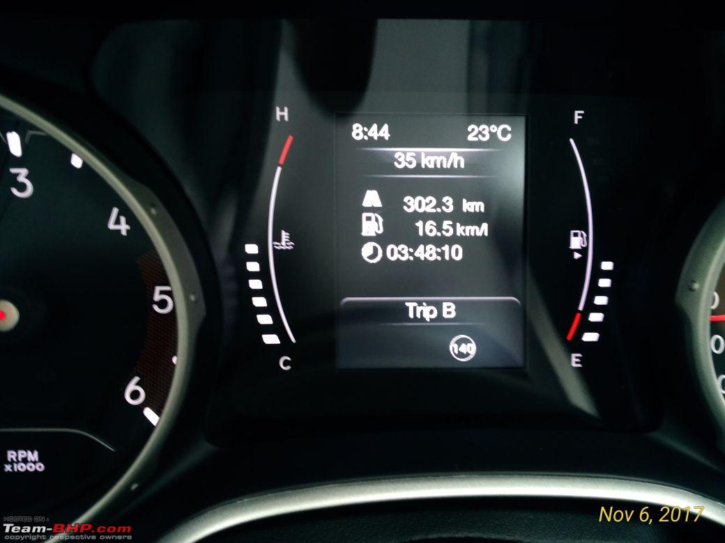

Got your point! I should be clocking around 700kms per week so should be able to share my experiences soon. Just crossed 650 on odo.
First proper highway drive today. Coimbatore to Bangalore via state and national highways
Coimbatore to Thoppur (Includes 40 kms of 2 lane state highway)
Jeep Compass : Official Review-img20171106wa0008.jpg
Below numbers are with a heavy foot
Krishnagiri
Jeep Compass : Official Review-img20171106wa0009.jpg
Hosur
Jeep Compass : Official Review-img20171106wa0010.jpg
Bellandur (Hosur to Bellandur via Bangalore- Sarjapur)
Jeep Compass : Official Review-img20171106wa0011.jpg
Breakfast stop!
Jeep Compass : Official Review-img20171106wa0018.jpg
