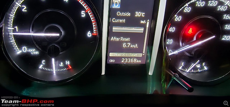

My friend's ~18 month Legender's oil is vanishing in ~3000 kilometers. Local Toyota people did not share the job-card and are reluctant to share any further details.
My friend's woes does not seem to end.
Now, diesel leakage is detected and the fuel tank is empty now in ~150 kilometers. While, job card is not shared, this is the screen shot, which has all details.
2021 Toyota Fortuner Legender & Facelift Review-whatsapp-image-20230427-19.50.15.jpeg
That is a lot of work for a Toyota which has done some ~23,xxx kms.

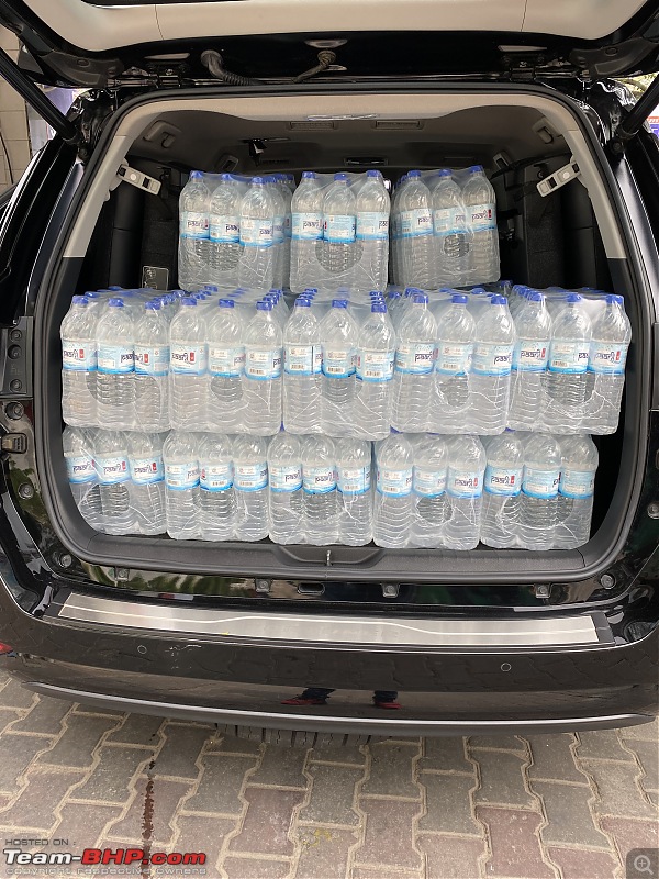

A relative asked me to run an errand for them which was on my daily route, i asked what is it? The simple answer was, just have to pick up some water bottles from that place you can manage in your car. When i got there it was not some water bottles! But 30 Crates. Got them fit in the boot. At first i was cheesed of, but after they all fit in, i was like hell yes this is exactly why i bought this in the first place so i could use it like a tempo
2021 Toyota Fortuner Legender & Facelift Review-a0030e9544194111a67112a8d37dde9b.jpeg
Awesome! I had a similar experience recently when a relative asked me if they could use my "truck" for hauling some mattresses since the tent house guy was charging a bomb for short distance delivery.
