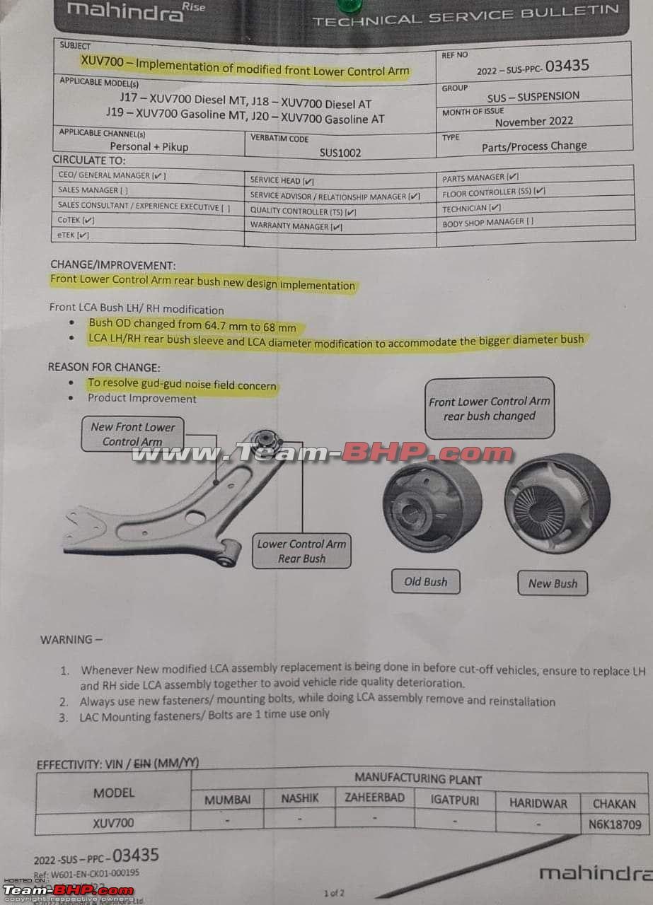

Official service bulletin issued for change of the lower arm bush of the XUV700's suspension to resolve the front suspension noise reported by many existing owners.
Attachment 2383760
Thanks to Kumar Gaurav for sharing!

Hi, its difficult to recognise by looking at this image. However, considering this was a test drive vehicle, I’m pretty sure it would be running with the old lower control arms. As Mahindra service centres in my area are giving least priority to arms replacement of their customer’s vehicle, let alone their own old test drive vehicle.

I too got my 700’s lower control arms replaced in mid Dec’22. I feel 90-95% reduction in the overall thud noise. But little noise still comes out sometimes. Perhaps, I’m overthinking.
Anyway, like most of the XUV700 owners with replaced arms, I’m overall quite happy with the new assembly.

It would not be possible for anyone to say whether this is the old one or new one from the picture that you have clicked.
The only change between the two is that the OD (outer dia) of the rear bush has been enhanced and that part is hidden.
