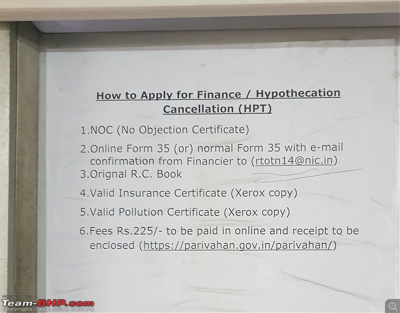

Thanks TAHR for your detailed instructions. It helped a lot when I went to submit the documents for hypothecation removal.
I reached the RTO office at around 10:30. Counter 15 was closed. There were a few people waiting outside. After about half an hour, a person opened the counter and asked us to go to the main gate and show the papers to the lady there. The lady verified the papers and put her signature.
Then I was directed to go to counter 16, where another official verified the online records in parivahan and put a seal. After that, submitted everything at counter 17. The official at that counter asked me if I had two copies of the fee challan. I had only one copy, but he nevertheless took all the documents and gave an acknowledgment slip.
Saw this notice pasted outside counter 15 which lists the documents required.
ARTICLE: RTO Hypothecation Removal Process - Step by Step Guide-img_20210312_103602.jpg
