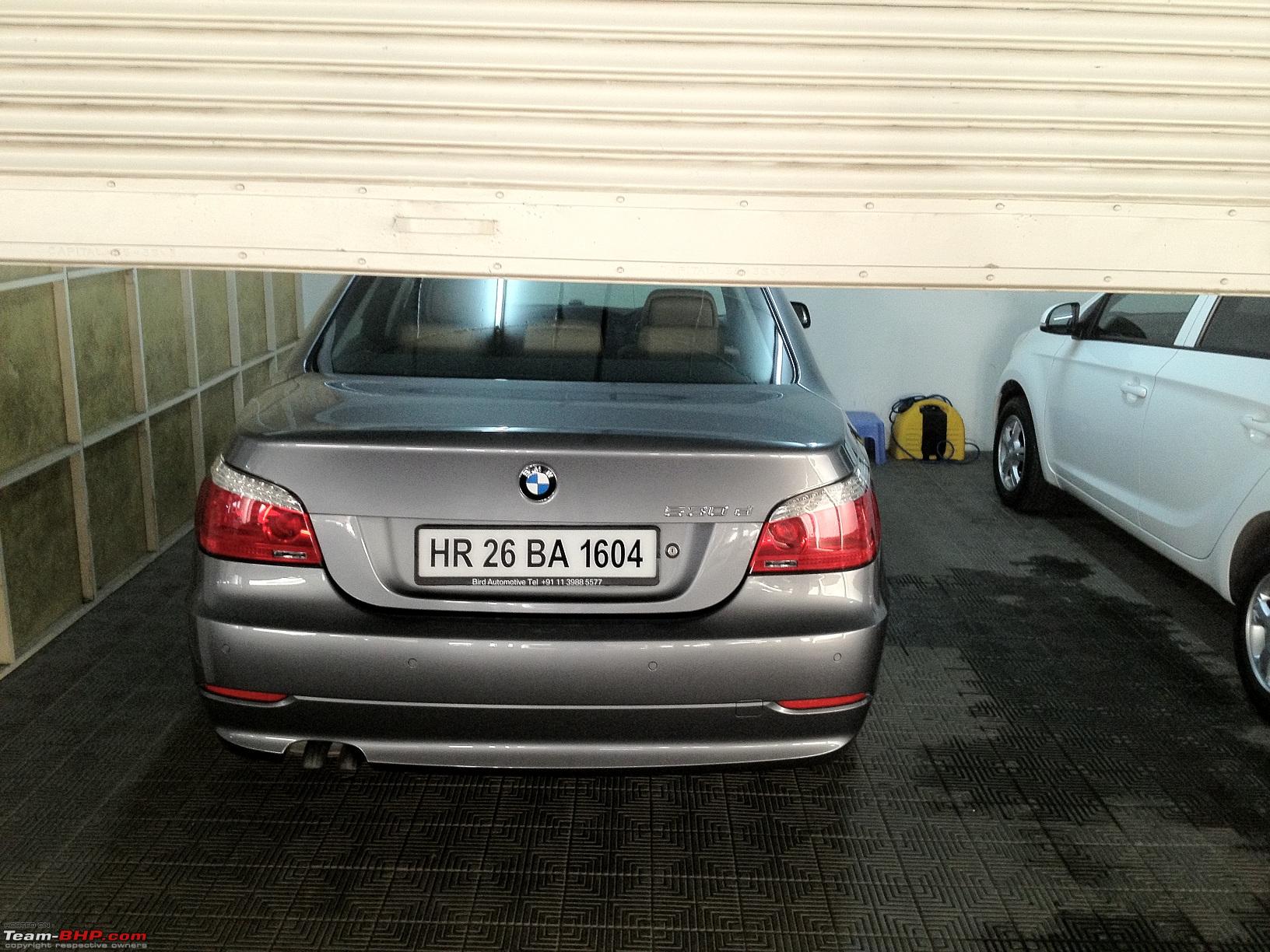

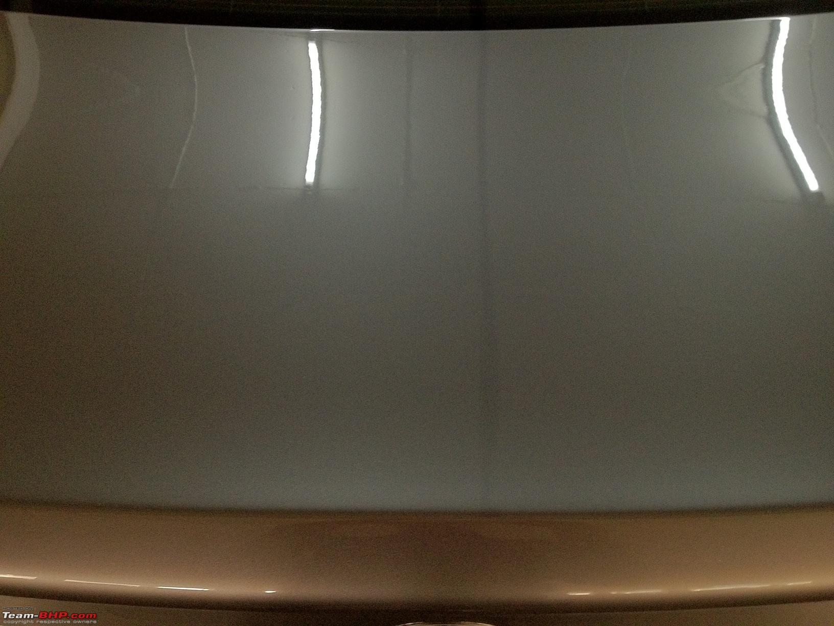

Hi,
I got a Meguiars DA Polishing machine G220 V2 from UK & decided to test it out.
Washed,Shampoo & Clayed using Meguiars.Thereafter using Meguiars Ultimate Compound buffed the whole car to get rid of the swirl marks followed by meguiars nxt generation tech wax 2 & buffed it out.The results were spectacular.
Attaching pictures clicked with Iphone 4S,not really doing justice but 2 days well spent.
Cheers.
