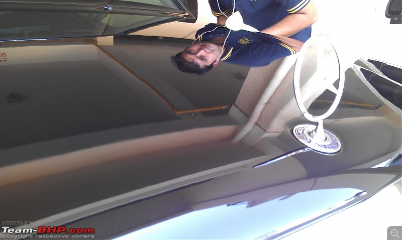

Just thought i share my weekend detailing result with you guys
Car: W124 E220
Color: Black [020]
Stuff Used
1. Gritt Gaurd
2. Ran out of Car Wash--> Dove Shampoo [What is safe for hair is safe for the car].. PS just one time.. so dont kill me
3. Wash Mitt
4. Megauir Clay
5. Meg Ultimate Polish
6. Collnite as the final wax
Just a question: i applied a very thing coat of collnite.. do i need to apply more coats??
Meg Polish.. gives a immense depth.. but the wax i noticed reduced it..
Result..
Camera Used: HTC Sensation XL
