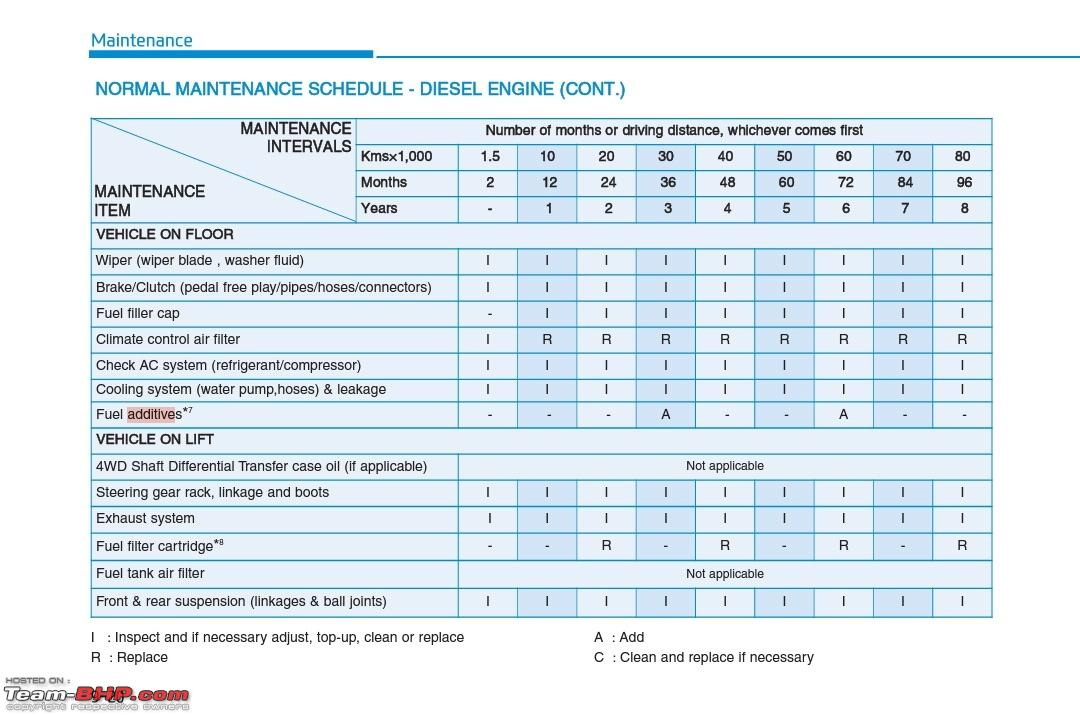

Re: The Fuel Additives Thread
Originally Posted by prabhu.reddy92 View Post
As mentioned in the manual, i couldn't find a list of fuel additives approved by Hyundai for my 1.4 CRDI engine nor anything from the internet.
Don't worry, get any fuel additive that you prefer and add before filling up the tank. You can use Liqui Moly or System-D or Adon-D.
Hyundai does recommend adding additives at an interval of every 30,000 kms. You can find that in the owner's manual also:
You can also find them in the Value Added Services provided by Hyundai ASC's too:
I own a 2017 Hyundai Creta 1.6L CRDi and the screenshots are from the owner's manual of my car. My car has covered 82,000 kms as of date and have been using fuel additives every alternative full tank (Dosage: ~ 1ml per litre).
