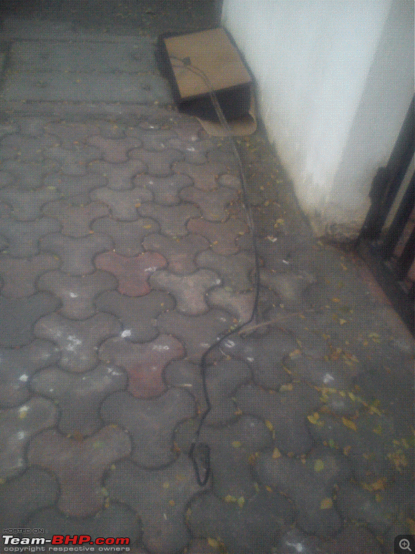

Hi guys,
disaster struck my Honda,again, this time it was the fuel pipe which was gnawed at by a rodent.Most people have rodent problems under the hood.My car was intruded from below the seat close to the location of the fuel filter where the pipe comes from the filter and leads to the engine.
Below are some pics
The pipe was chewed at this location under the seat. The rear bench and upper seat had to be removed along with the casing covering the fuel strainer.
Honda Civic : Maintenance, Service Costs and Must dos-dsc_0041.jpg
If you see carefully you can make out debris & leftovers from whatever the rats were eating.
Honda Civic : Maintenance, Service Costs and Must dos-dsc_0042.jpg
You can't really make out clearly but the pipe was chewed just a little above the metal joint.
Honda Civic : Maintenance, Service Costs and Must dos-dsc_0043.jpg
The workshop i went to (WagenWorkz, Jatin Patel) tried to repair the pipe as a temp measure.
Honda Civic : Maintenance, Service Costs and Must dos-dsc_0044.jpg
Honda Civic : Maintenance, Service Costs and Must dos-dsc_0047.jpg
However once the pipe was fitted back into the filter and the car was started it spilled petrol again.
Jatin recommend that the entire assembly be changed since it is a very critical component and it was better to be safe.A new pipe was ordered and the entire assembly had to be removed. The pipe is such that it's a single piece and it was my plain bad luck that it was chewed at.
Honda Civic : Maintenance, Service Costs and Must dos-dsc_0049.gif
The total damage, 4800 for the original Honda Pipe, 2000 bucks labor and 600 bucks for towing the car to the garage. 7400 just for a small gash on the rubber pipe.It was just not my day.

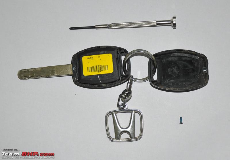

For sometime now I found the key to be erratic in locking and unlocking. I needed to do it twice/thrice to get it locked/unlocked. Its been six years and probably the battery could have lost its charge given my frequency of Car usage.
Decided to get it changed, a simple DIY of 5 minutes and costs Rs 50 for the Cell. The Cell is CR1616, and available at Rs 50 from your local watch repair shops, and also on ebay if you don't want to walk around to find a watch shop
Tools required - a 2mm precision screwdriver.
That's my Civvy's key - tired and worn out after the heavy usage
Honda Civic : Maintenance, Service Costs and Must dos-dsc_0401.jpg
Honda Civic : Maintenance, Service Costs and Must dos-dsc_0403.jpg

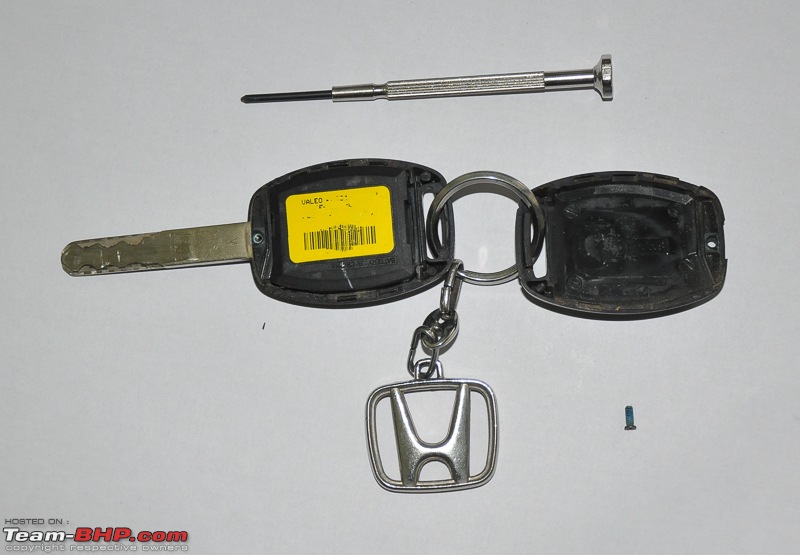

That's the screw which keeps all intact
, you need a precision 2mm screwdriver to unscrew
Honda Civic : Maintenance, Service Costs and Must dos-dsc_0402.jpg
The key fob opened
Honda Civic : Maintenance, Service Costs and Must dos-dsc_0404edit.jpg

The back cover of the electronic unit is attached with a locking mechanism, it is easy to open it out
, the cell is already visible
Honda Civic : Maintenance, Service Costs and Must dos-dsc_0407edit.jpg
Just pull out the cell
Honda Civic : Maintenance, Service Costs and Must dos-dsc_0408edit.jpg
The Cell is CR1616
Honda Civic : Maintenance, Service Costs and Must dos-dsc_0409.jpg
Get a new cell, put in there and reverse the process
Honda Civic : Maintenance, Service Costs and Must dos-dsc_0746.jpg
I went with this fellow
Honda Civic : Maintenance, Service Costs and Must dos-dsc_0745.jpg
Many makes are available at various price points. This fellow was quoted at Rs 85, finally obtained at Rs 50 from a local watch repair shop.
laluks is offline   (7) Thanks
