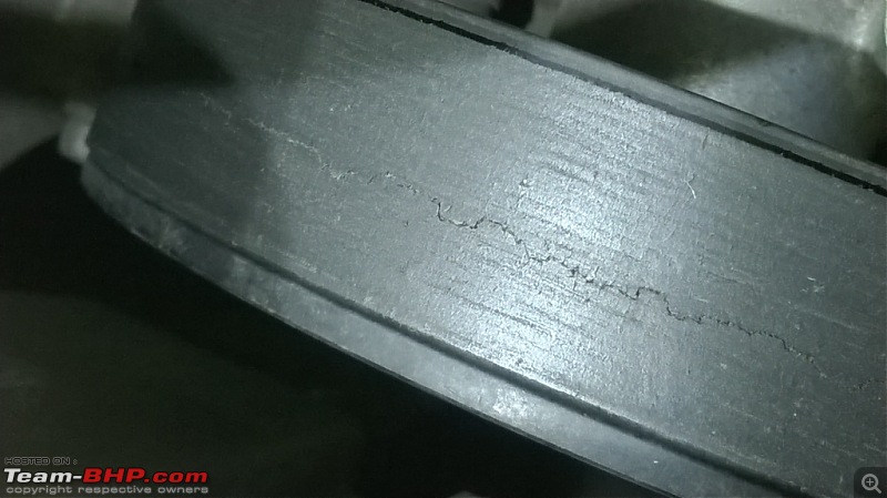

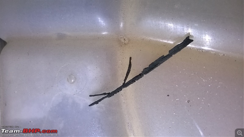

I own a 2010 1.4 TDCI figo from the initial batches and it has run 41000km till date and all the services have been carried pro actively. I have been noticing a hissing sound from the the serpentine belt area near the power steering pump since 2-3 months. It starts few seconds after starting up the engine and sometime it vanishes after the has warmed up or it continues to make hissing sound at a much lower level.
Today I inspected the belt; only to find that it has started shredding - cracking and has become rock hard. I located the shredded part and cut it, but the hissing sound continues.
I know the belt has to be replaced. But isn't it too early? Does it require simple belt replacement or any other part associated with it like idler pulley and tensioner (read it on somewhere in the forum)? I feel that apart from the belt there is a sound of a kaput bearing somewhere which is making the noise. The nearest FASS is 100 kms away. Could the car be driven till there? Also, does anyone have idea about the approximate cost of the belt and other related parts/service?
There is a reputation of this belt snapping at around 50k km mileage. So yes, change it. Should cost <2k. Since your mileage is less, dampener pulley can be changed later if any noise comes from that side.
You can drive it to the service, but do so in the early hours of the morning without use of AC as we all know the 'kicking' effect of the compressor.
Get the belt replaced ASAP. It may otherwise snap and in this case the repairs are a lot more expensive as they will also replace a bearing, and change the oil. The snapped belt may tangle with something and cause further damage. It had happened in my Figo and it cost me approx 9 K to get it fixed. Noida Ford did a shoddy job of the replacement and the belt snapped again in less than 5 K km and this time pulled an engine sensor out. Got it fixed at an independent garage at a cost of Rs 3200. Finally apprehensive of high maintenance costs and reduced reliability, I sold the car off last month . It was 4 years 8 months old with 73 K on the odo.
