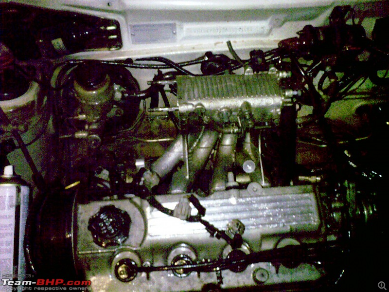

Been driving a 02mpfi zen and always loved it for the superb performance,went a step ahead got a esteem throttle body and its a bolt on to the zen,however found that th intake manifold hole for the air passage is 40mm just the same as the throttle body of stock zen and esteem is 45mm this was causing a bottle neck,removed the intake manifold bored the hole to 45mm to match the new throttle body and now it flies...car runs more free and feels nice....

Thanked: 349 Times
@scorpian ,Some pics please . How much was throttle body ?

here sum pics for reference,,,i did this all at home,removing the intake manifold was easy,however at one point of time i gave up as it wudnt budge,later realised it was due to the alternator support bracket....
if u look at the fourth pic u will see a blue ring drawn near the hole,this is the area that needed to be increased,i used a die grinder and did the job,for reference i used the throttle body gasket to see how much i needed to cut off.
u can also see the intake manifold has a lot of carbon just where the injectors are placed,i used 3m choke and carb cleaner to clear the carbon,besides i also got my injectors cleaned,a new intake manifold gasket is absolutely necessary.
All this can be done at home,provided u know and can remember where is what at time of fitting back.
I find the car way better and it responds nicely even with the ac on,earlier it used to feel dead with the ac.I reverted back to stock throttle body and could feel the difference.
Battery was disconnected to refresh the ecu,A scan showed no errors...
