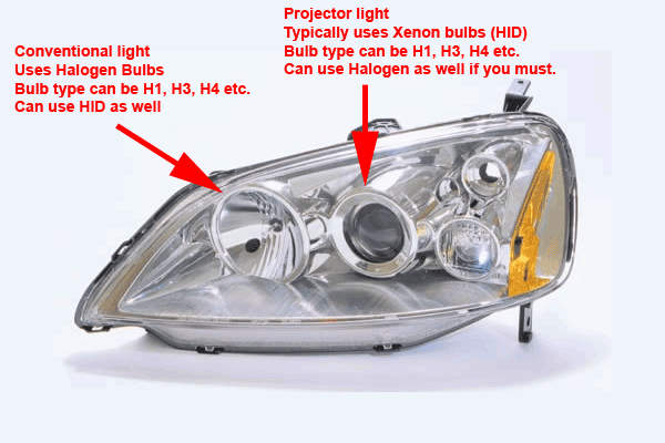

We're all here to learn as much as possible. Hope the illustrayion below will help others seeking to learn the basics of auto lightings.

And the figure/illustration posted by you is good and helpful.
