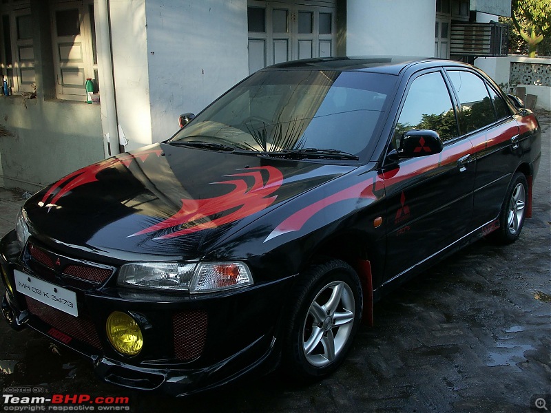

Fog lamps in stock location for Lancer
Searched this thread but didn't find a answer to my query.
I drive a lot on the expressway and later on sections from panvel to thane. This section is under construction and hence has a lot of debris/extra divider cement blocks/ obstacles kept just next to the divider. to add to my misery people don't care if they are blinding oncoming traffic and always drive on high beams.
I need a good set of fog lamps for my lancer that i can focus on these dividers and can keep my car away from these fender benders.
Please suggest some makes and how can I retrofit them to the lancer stock location in the front bumper.
I am a total noob on auto lighting so please specify what make, what specs ,what price where can i source and get it fitted in mumbai/thane.

Bright lights on your car(unless they are xenon HIDs) won't allow you to see when you are blinded. They can only force others to dip.
However when there is no oncoming traffic they can help
As for mounting HELLA fogs, go to any good accessory shop. They will drill holes in the bumper and mount a bracket there.
Don't go for "On the bumper" fogs as they hamper air flow to radiator, instead get the bumper cut use FRP etc., to have nice looking fogs inside the bumper.
Thanks Tsk for your quick answer.
I feel that the stock location will not make any exceptional changes to the air flow since they are just too far away from the radiator.
and i dont want the bumper to be cut. Its too beautiful to be cut
see pic below.
Name:  lancer front bumper.jpg
can something be retrofitted in the existing foglight panels on the side.??

Hey Leadfoot, I have installed Hella Projectors in my Tavera. Don't go for yellow lights. Hella 550 will be more than sufficient for you. It has 60W bright white bulbs. As soon as I switch on my projectors, I get a lot of respect from morons with high-beams!
You will need a seperate relay and wiring. The total cost will not exceed Rs. 2500. I have fixed the projectors on my crash guard. So there was no need for drilling. If you want to do it from Pune, let me know.

Oh ok, you have existing foglight panels. Thats good.
Try somethiing like this
http://www.team-bhp.com/forum/modifi...tml#post175411
Auto Lighting thread : Post all queries about automobile lighting here-21361.jpg
These are yellow, but you can go for normal lights. @chevy_lover I am not a fan of crash guards because even in case of minor shunt which will otherwise damage only the radiator, crashguard vehicles can get chasis damage, which can permanently damage the car to an extent that it can never be set right.
Moreover you do not have crumple zones.

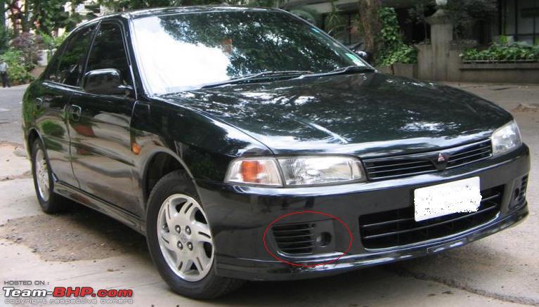

no nothing ghastly of that sort goes to my car.
I know yellow light has the most penetration power while using in fog. however yellow doesn't really appeal me in the looks department. so a yellow fog lamp like the pic is a NO NO .
I think I can get my existing foglight panels cut and retrofit lights to it. but which one???
what specifications to look out for fog lamps???

Leadfoot: Why not the stock projector Fog lamps that came with Lancer SFX?
They will not blind the oncoming car but will give you clear road view
yes yes please post clear pics.
Yes stock projector fogs of SFX might make more sense but wont hey cost a bomb if i have to purchase them from HM - mitsu ?? will i get them else where???
my GLi doesn't have any existing wiring for it which means i still have to make custom wiring and it wont be a straight fit.

leadf00t, I posted the pic just for an example. You need not go for yellow lampls you can go for smaller lamps too,
I have seen Lancer SLX lamps, and they won't help much as illumination is not much unless you are planning to put in HID.
you can put in slghtly smaller hella white lapms without cutting the bumper at all.
