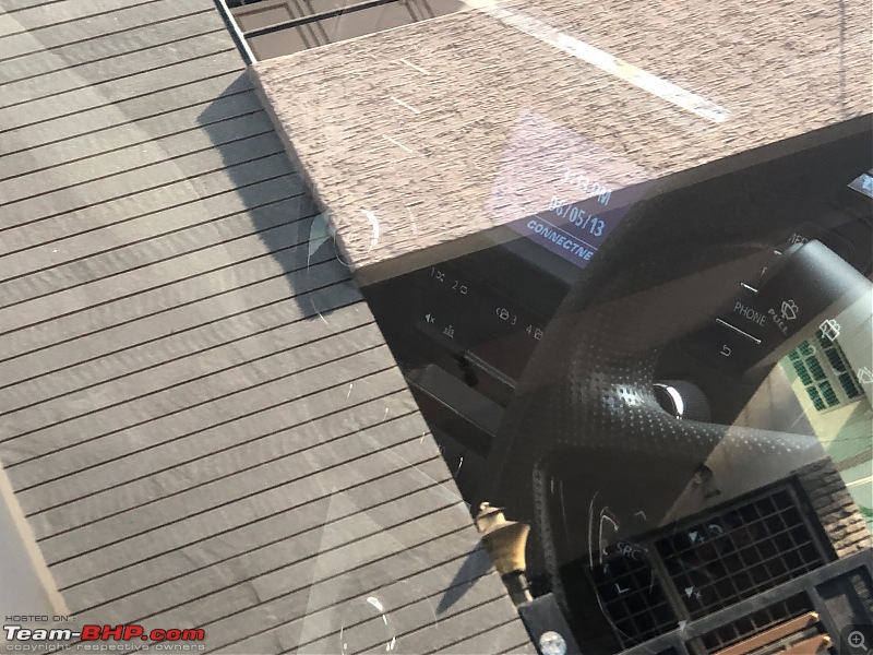

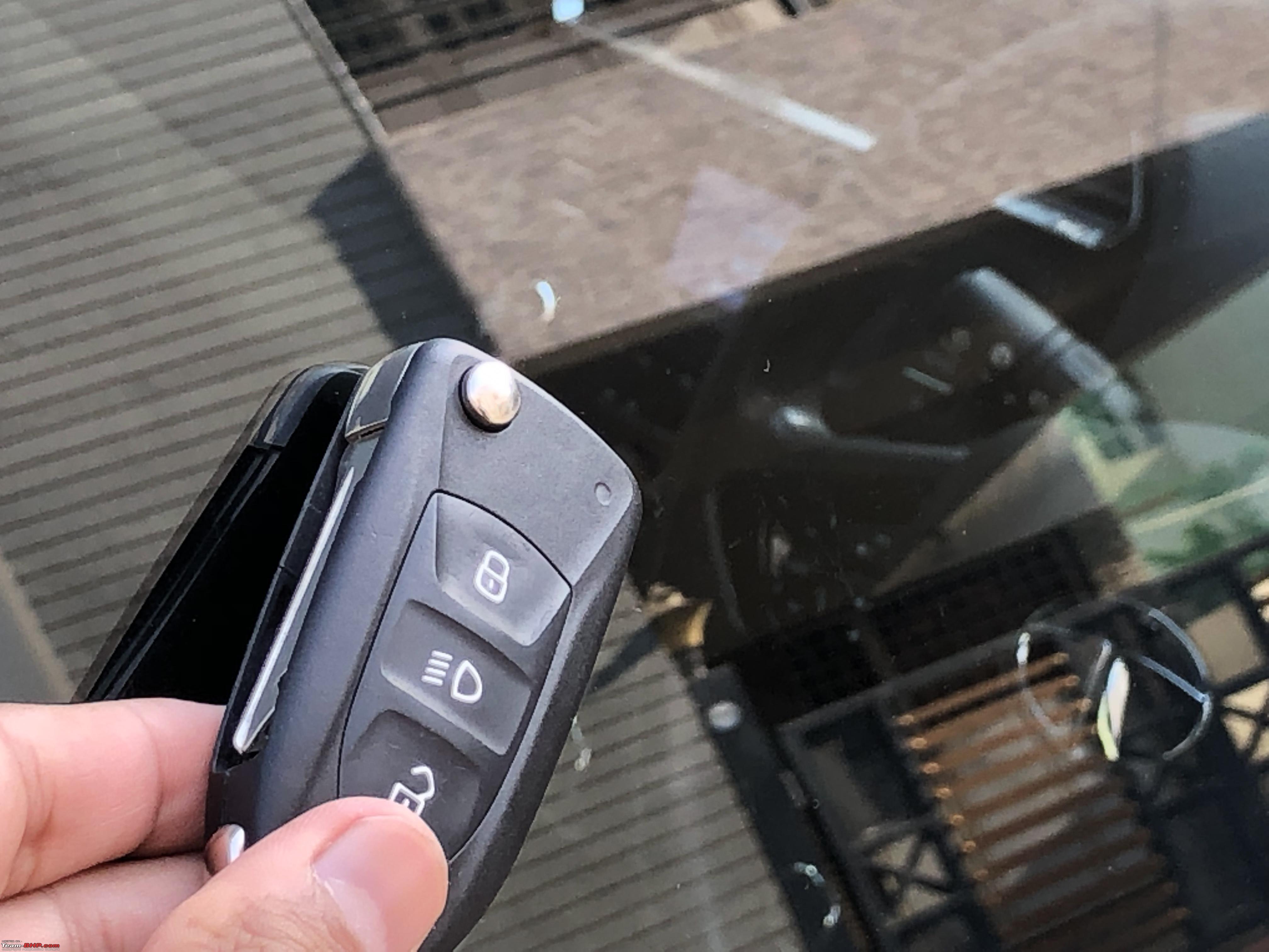

Car keys outside, car locked. Woke up to this. The audio unit is still running. The car won’t start cause it’s drained the battery completely. Have disconnected the battery for now.
Attachment 1867641
Attachment 1867642
Attachment 1867643
Was it running on the one hour mode? That works even with the key out for 1 hour. If it was not, the head unit must be defective. Ask for a replacement.
Motard_Blr is offline   (2) Thanks

Re: Tata Tiago : Official Review
Ok the unit was working in some sort of standalone mode, it wasn't detecting the car at all. The display remained "ON" throughout the night, it drained the battery completely and we couldn't start it this morning. Finally got my local garage guy to start it and we took it to Mysuru Road Concorde Motors.
So back from Concorde Motors, Mysuru Road. The Harman guys couldn't get the replacement unit to work either, so had to leave the car with them. They were baffled too and had no idea what was going on.
Even the replacement unit did not work. It does not connect to the car's CANBUS system. It does not show "Vehicle setup" as well as the reverse parking sensors. Everytime you turn the car ON, it boots into One Hour mode.
Very annoying. Wasted a whole day without any result.
The link from the audio system to the car is the BCU. Since the replacement unit also didn't work and assuming that that was ok, the BCU might be the culprit. Ask the service engineer to run a diagnostic check on that.
