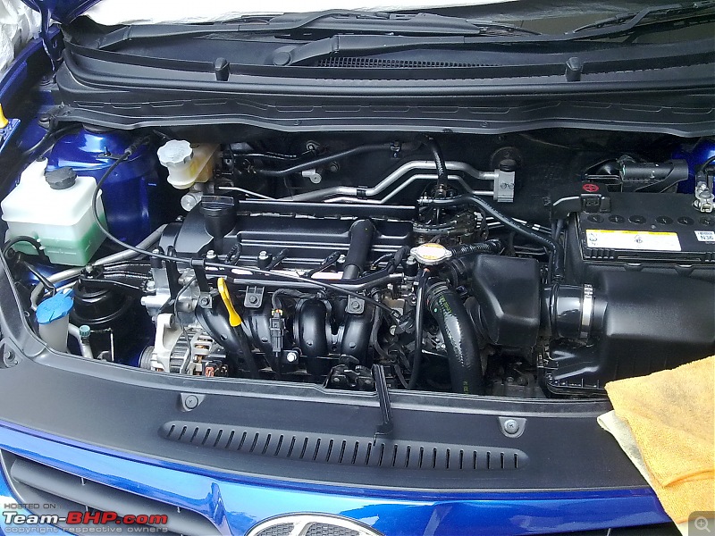

Had detailed my i20's engine bay this morning!
It was super dusty!(you could imagine the dust in the engine bay after nearly 3K kms!)
sorry no before pics(it was so dusty that I couldn't stop myself from cleaning it asap!)
Enjoy the after pics

Wow Sohail!
That's some amazing work The after pics are so awesome, even cleaner than when your I20 rolled out of the showroom i guess ! Five stars to your detailing !
Please do enlighten us on the procedure & what you used, some WIP pics perhaps

Oh! I'm just an amateur!!
(before washing, just as a precautionary measure - Cover the alternator with a small plastic bag)
btw I got hold of a bottle which you might have seen with ppl who are applying sunfilms
(white bottle/jar with a spray attachment and a manual pressure pump)
Its great for this type of washing!(for isolated places) (I didn't use a hose or a continuous water source)
and I used distilled water without any form of salts(as when it dries, it doesn't leave any residue)
if hard water dries on the engine, it leaves behind calcium salts which bake over time due to engine heat and then after-wards, are a pain to remove!!
also car wash shampoo in a spray bottle and a brush to lather up and remove dust etc. in hard to reach areas!
after washing, instead of firing up the engine to dry it I wiped it down and dressed!
looked nice!

Thanks for the inputs ! Btw, what did you use for the dressing ? I used vinyl dressing once & the results were good !

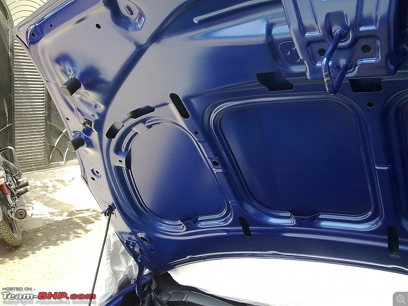

How did you get the inner panels of the hood so sparkling
nirmaljusdoit is offline

^ Vinyl dressings on rubber pipes and hoses which are away from the engine!
and slight Tire gel(I had Megs tire gel at hand) on hoses and pipes closer to the engine(as it can withstand slightly higher temps)
An all purpose sealant on plastics
hood was washed with car shampoo and brush used to work up lather + it can reach into those small holes etc.
then sprayed down > wiped > sealant
